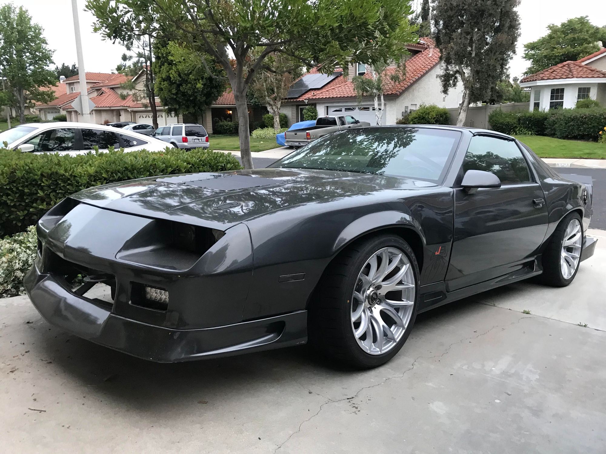

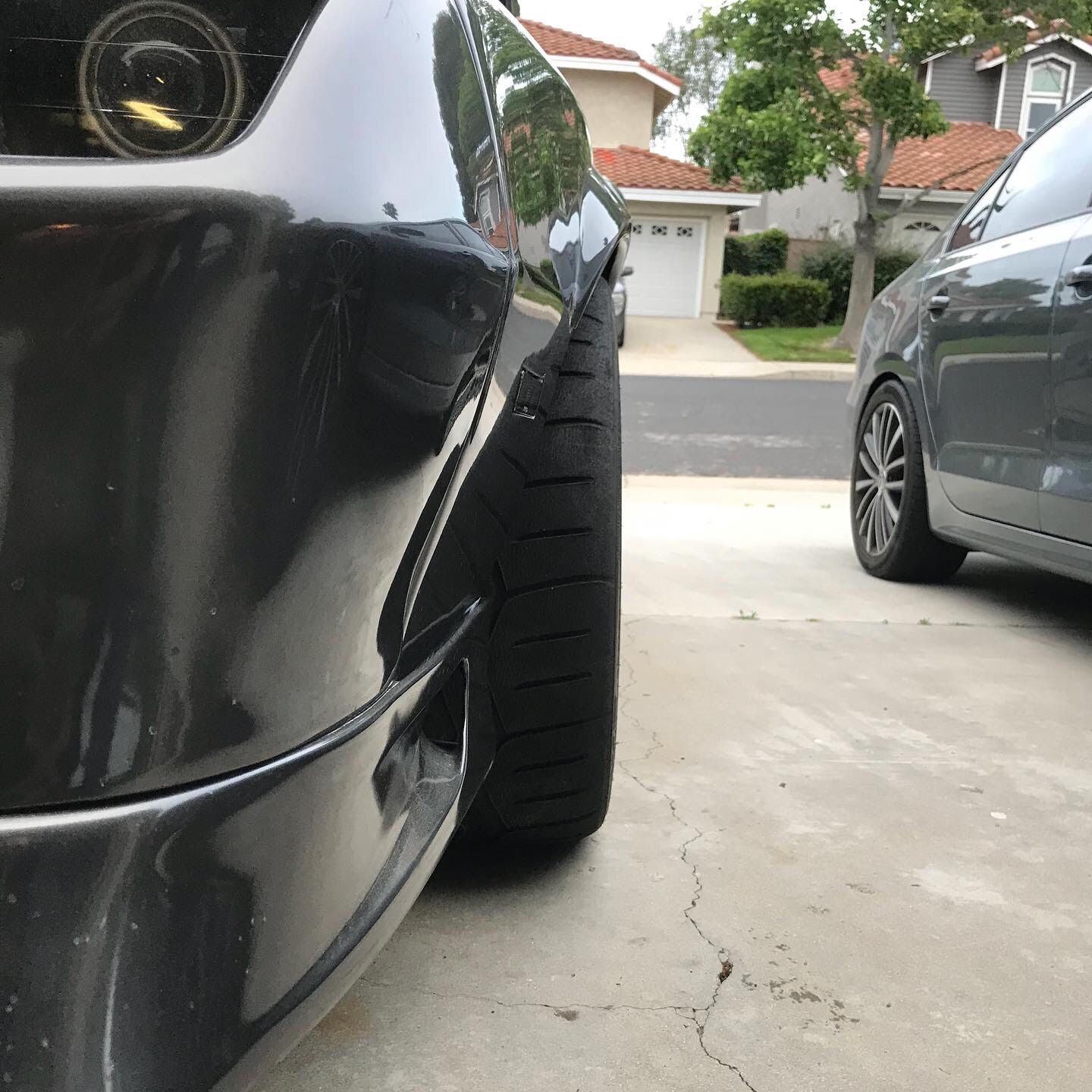

heres nime, finaly after it just sitting and pARTS COLLECTING DUST, MY WIFE PUSHED ME TO MAKE TIME AND AT LEAST GET HER ON HER NEW SHOES, here she sits... at least it rolls now lol.. 315 30 18 on all 4

I ran 295/35/18 up front for years on a 10.5" wheel. They fit nicely. I chose the size because there were/are a lot more tire options in a 295 than the wider sizes.

looking good brother I passed by your way took trip for extended weekend in Yosemite and San Francisco

What kind of spacer are you guys running to put 10.5" wheels up front?

depends on wheel specs if custom wouldn't need any

Just wondering as it appears Morrow has the C7 wheels which have the same offset as C6 wheels which can fit our cars with the "normal" spacer kit to run the 4th gen wheels.
That's more what I was asking is if the 10 or 10.5 wheels fit up front with the normal spacer sizes that everyone runs for the 4th gen wheels

you can search couple guys have done it
I could be wrong but its still 2" if I'm not mistaken

i was on a c5 wheel with 2 inch spsacers, im now on an 11 inch wide wheel up front, no spacers. though keep in mind my front suspension is heavily modified and in no way shares the same clearances yours does. im on 315 30 18 on all 4 wioth coilovers and no spacers with a zero scrub radius
