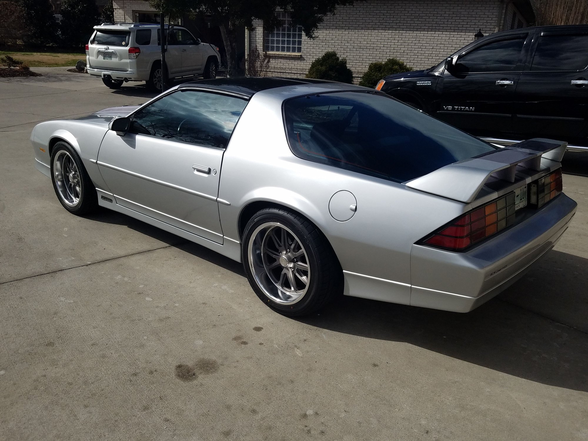

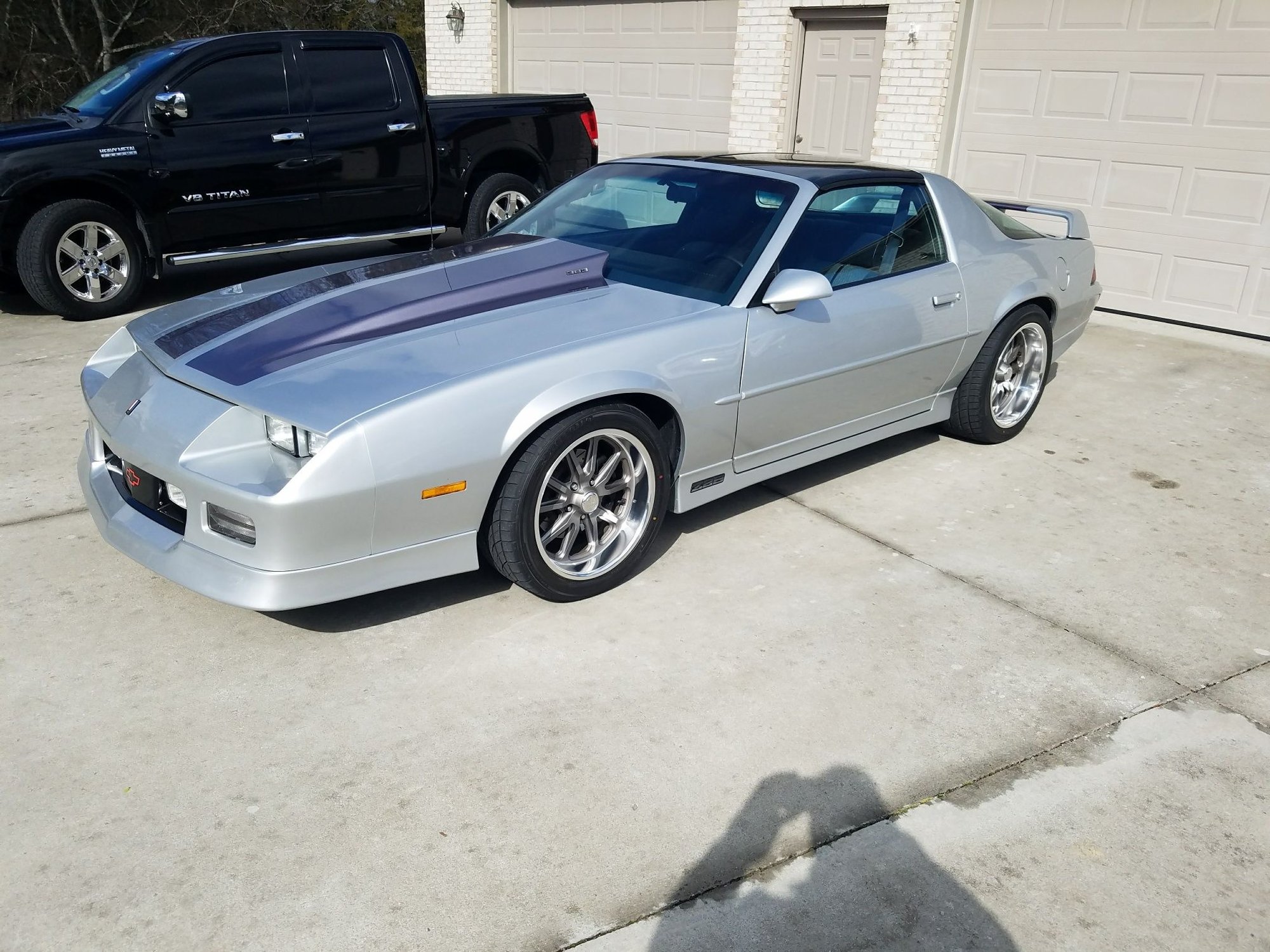

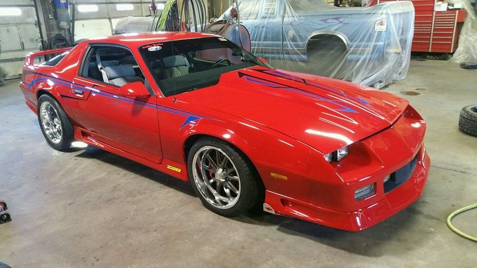

Here are pics of some US Mag Ramblers / 18x8 in front and 18x9.5 in back on a third gen. These wheels have the same backspacing as the wheels I want.
They are both memebers here. Hope they dont mind me using their pics.
