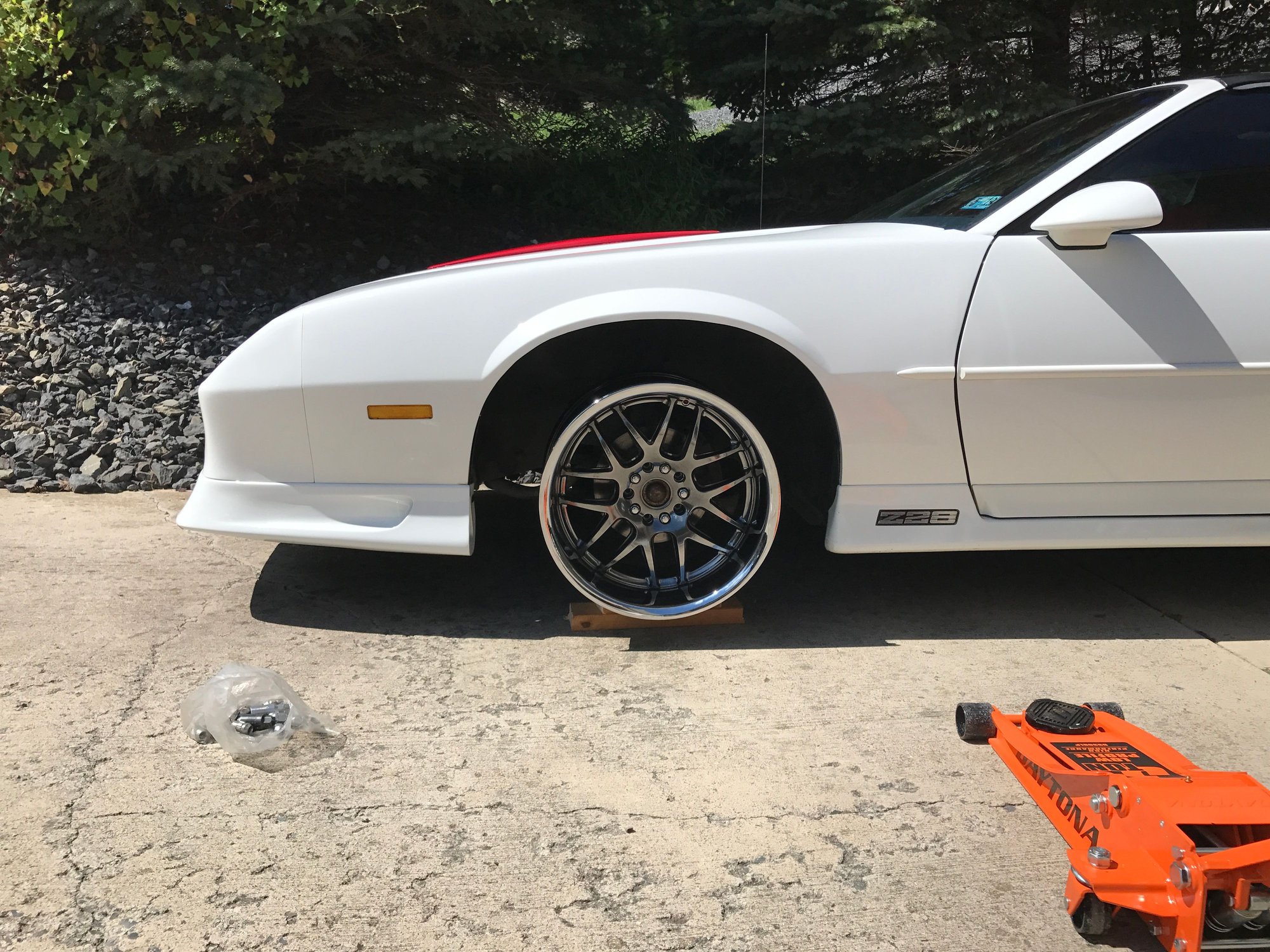

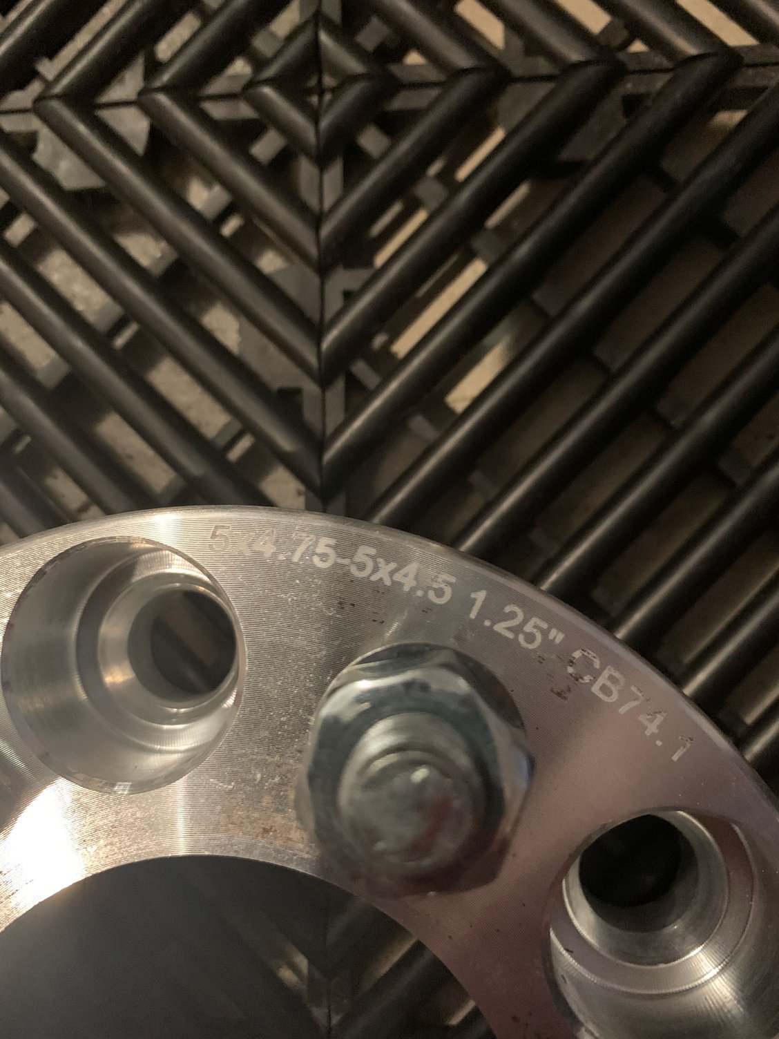

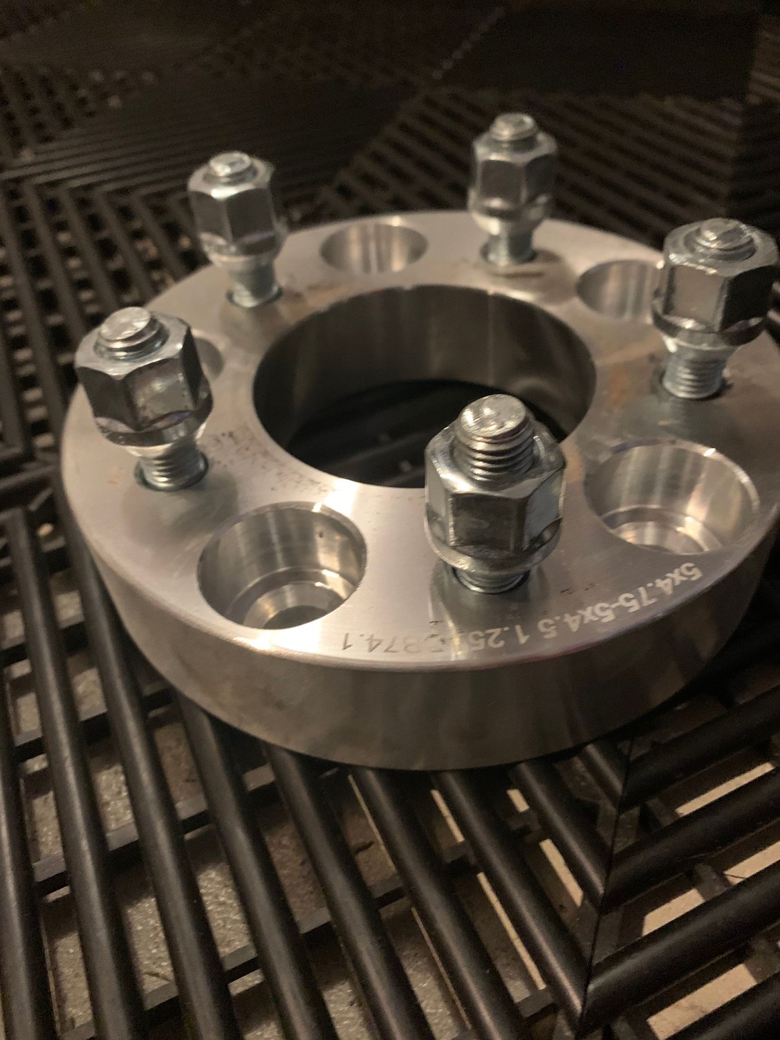

mine are 1.25” adapters to help clear the front hub and accommodate a 5x120 bolt pattern. The adapter or spacer you use will really be determined ultimately by the wheel you’re planning on going with. Bolt pattern , back spacing, offset , etc will all determine what you need. In my case, I will eventually be running a 18x10.5” wheel on all 4 corner
