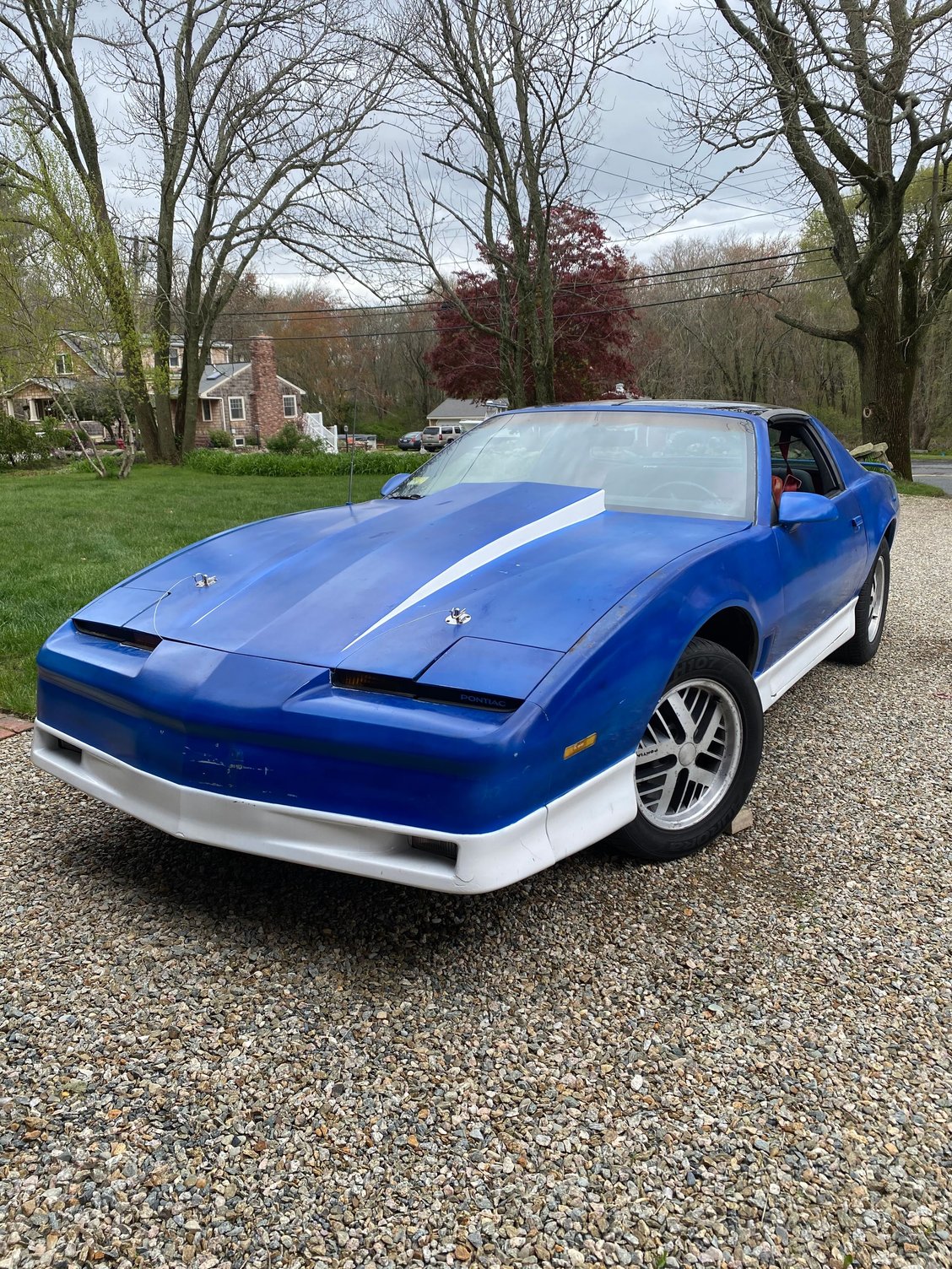

Does anyone know the weight of the 16x8 trans am wheels compared to gta wheels
those wheels^

I can tell you that when I had tires mounted on those wheels (like in your photo), total weight was ~50 lbs. When I swapped the tires to OEM GTA wheels, total weight was ~40 lbs. I believe the GTA wheels are ~17 lbs and the Trans Am/Formula convex wheels are ~26 lbs. Those are pretty much the heaviest OEM third gen wheels.

Just checked a GTA wheel,... 16.8lb.

Half the reason the cross lace rims came about was to keep the weight under the gas guzzler tax limit.

I have a spare 16" convex rear wheel, weighs 24.4#. A front wheel will weight a little more, probably about 25#, due to its thicker mounting surface.
