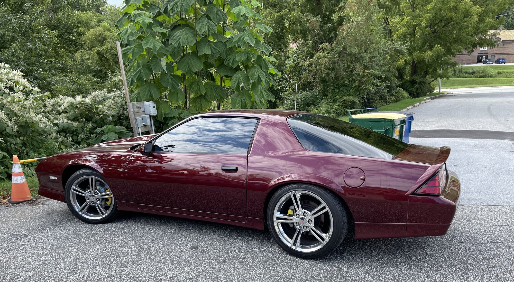

Current setup. The rear just clears the lip on the quarter. It was rubbing with a 1" spacer so i went with the 3/4"

Well they dont fit. The offsets make it worse. The rears will bolt up on the 4th gen rear with no spacer but they sit way to far back that with the tire it will make a lot of work to make them fit. With the 3/4 spacer they stick out to far and will get torn up on the fender lip. So Im gonna have them switch it out for the 19x9.5. Now the front fits but the inside clearance is real close to the coilover and it sticks out past the fender lip. Not sure how you guys run a 9.5 on the front of these cars. Im glad I didnt mount the tires because then id be stuck with these wheels
So for reference for anyone else looking Weld Venturas in 18x9.5 50 offset in the front will clear with a spacer in your not lowered and dont care if the tires stick out a little. They will fit the rear with no spacer on a 4thgen rear

With the 3/4" spacer i was using on the c6 wheels the wheels fit no rubbing on the inside but they stick out almost flush with the outside edge of the quarter
panel.
