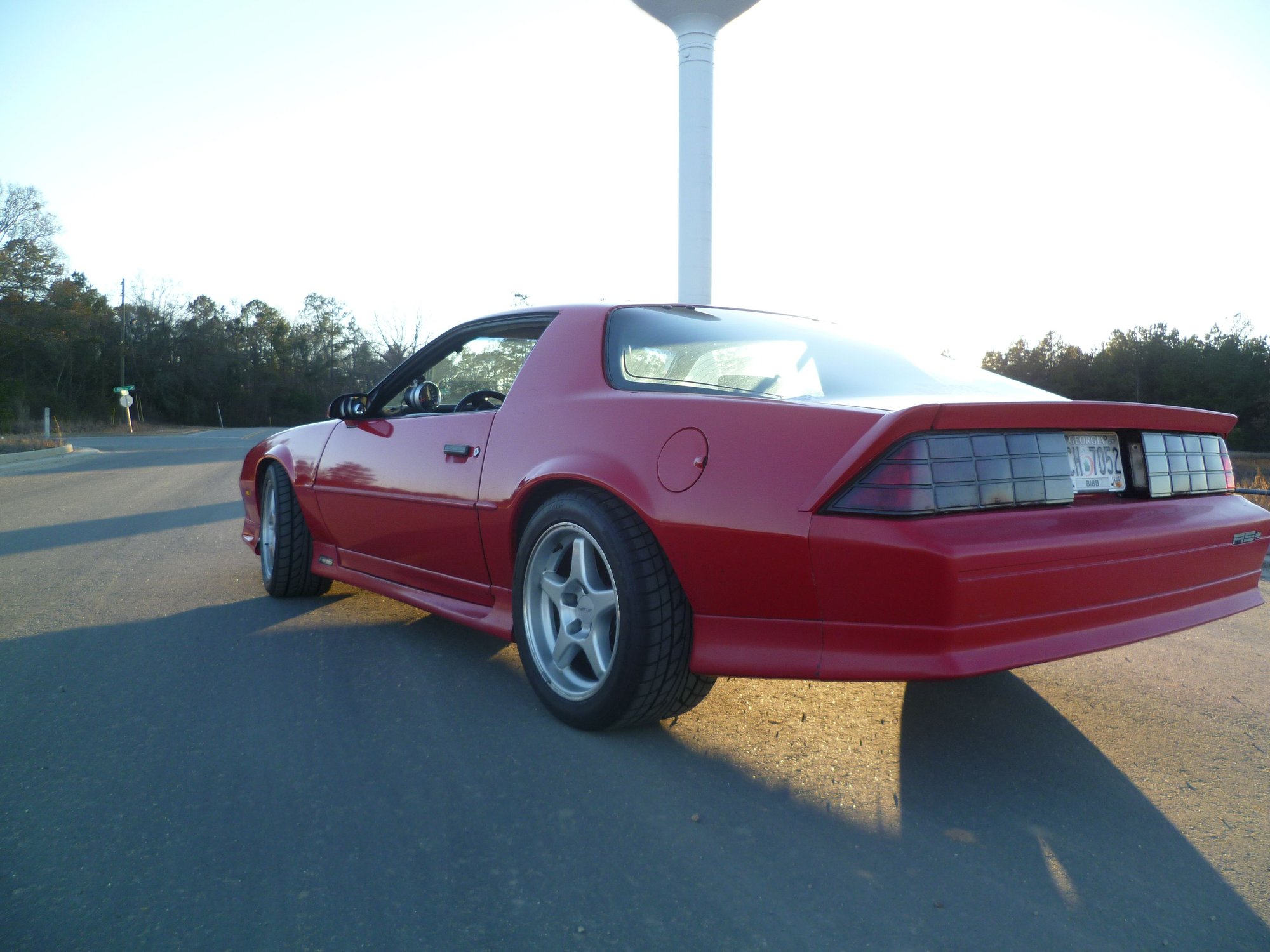

I agree with literally everything you just said, but I happened to be in here posting something else and noticed this post so I figured I'd chime in with my experience and load up some pictures for people who are curious after the photobucket implosion years ago probably.
I think these tucked pretty well, I think I may have had a goldilocks zone of tuck, fitment, and ride height (I was limited by my exhaust and couldn't realistically go any lower because they never rubbed on the rear fender lip that I noticed.
That said I DID hammer the inner fender tubs pretty aggressively, but I was not willing to lose the bump stops. If I jacked up the car and let the axle droop, the wheels would "catch" on the bump stops, and so I had to work around that taking the rear wheels off if I expected to have a need to unload the rear suspension. These did rub in autocross situations, but because I had them on and off so much due to the aforementioned bump stop issue I could monitor the rubbing, and it only ever rubbed on the passenger side. I could never quite get the panhard bar perfectly centered. I think if I could I probably could eliminate the rubbing. But when you autocross it really rolls over the tread of the tire and I think there's a certain level of that that makes a little tire rubbing unavoidable. But it never damaged the car or tires significantly so it was pretty minor. I think with normal every day spirited, enthusiastic driving you'd never manage to get them to rub. I could never hear them rub, I'd just see evidence of it later, just to echo your "managing of expectations" sentiment.
I think you can tuck these this well and have the car not rub, but you have no room for error on the suspension adjustments (adjustable LCA's and panhard etc). And I think it's probably arguable to some people that these are "tucked", but I was pretty pleased with it. It definitely doesnt have the 3rd gen wheels on a fourth gen axle look.
Sorry for reuploading these pictures again, but I find searching TGO threads to be invaluable so I odnt want to deprive anyone else of being able to see examples in the future.
And lastly to TA Guy, I just got a set of Hawks 17x9 wheels, which are apparently 5.5" BS, +12 Offset, and this is how they fit. I also think there's no point is going wider that 9" in the front, since 275 is the widest common tire size and 9.5" wheels are just going to be heavier and I think our steering boxes just dont like really wide sticky tires.
