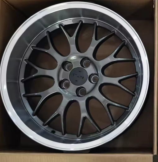

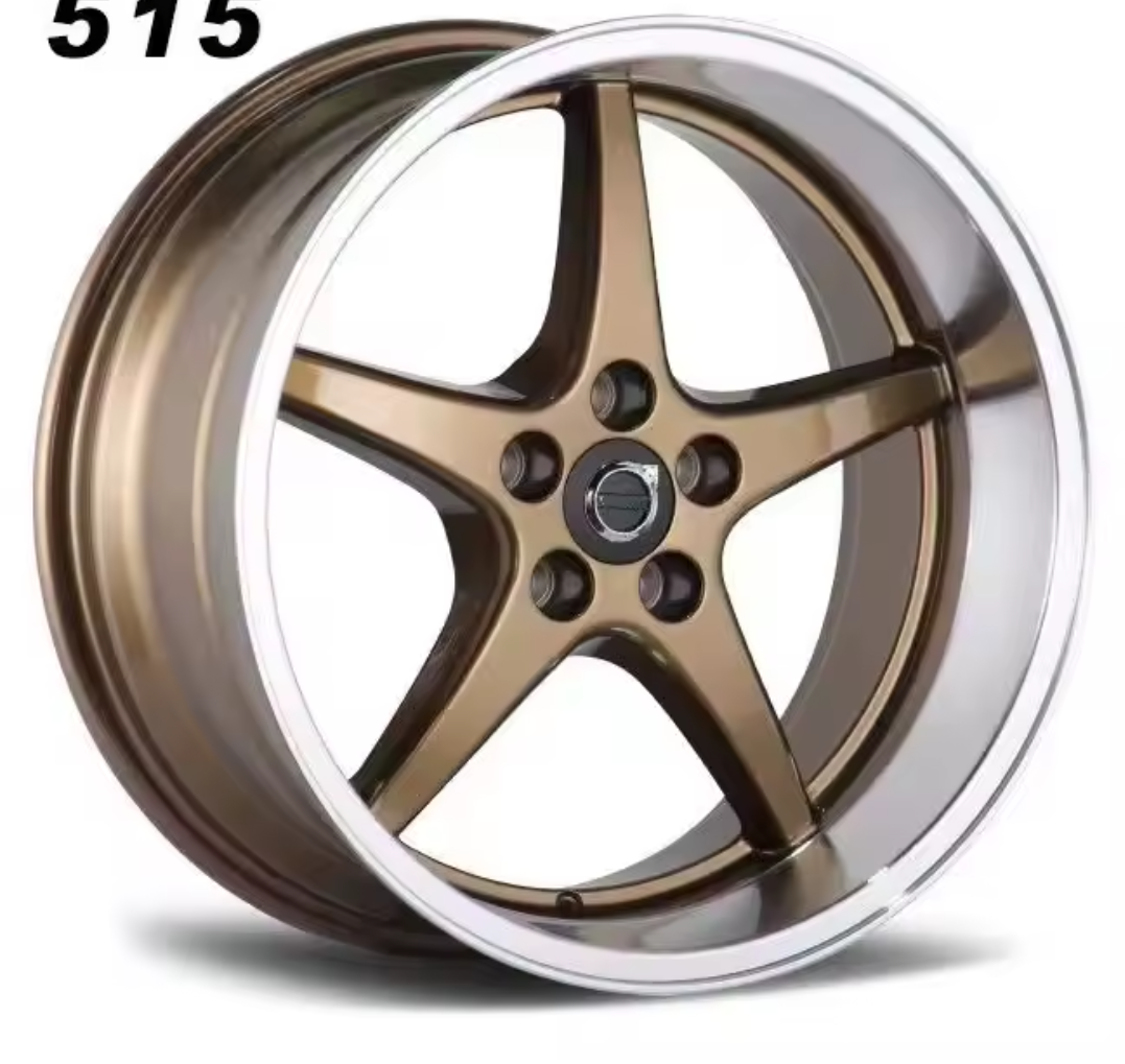

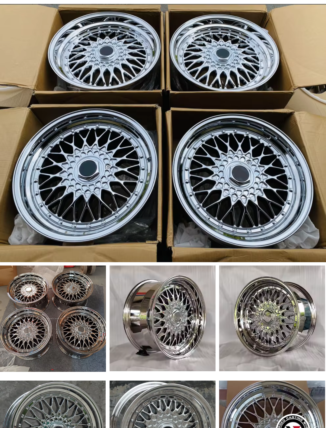

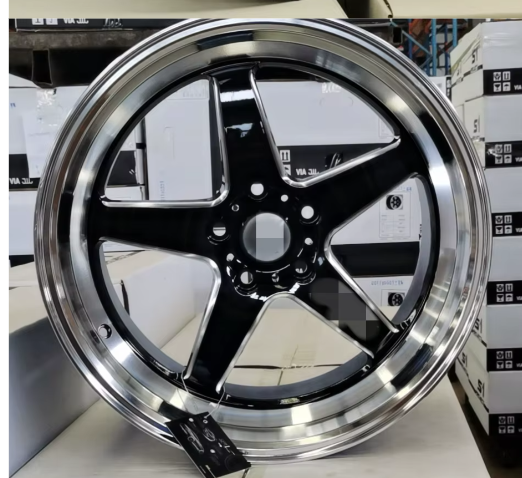

Sooo these are a thing now I see. My buddy got a fully custom made set for his C6Z, the entire ordeal went super smooth. Dealing strickly with the manufacturer, the logistics, the finished product turned out amazing... I'm asking for advice on what actual wheel sizing to go with. Right now I'm running some BMW wheels that came off of my buddies 06 GTO. I'm probably going to mock the sizing an maybe adjust the front a bit to get a little more of a dish and help offset some rub on full lock....
I do have a 4th Gen rear end and the rears fit perfect.

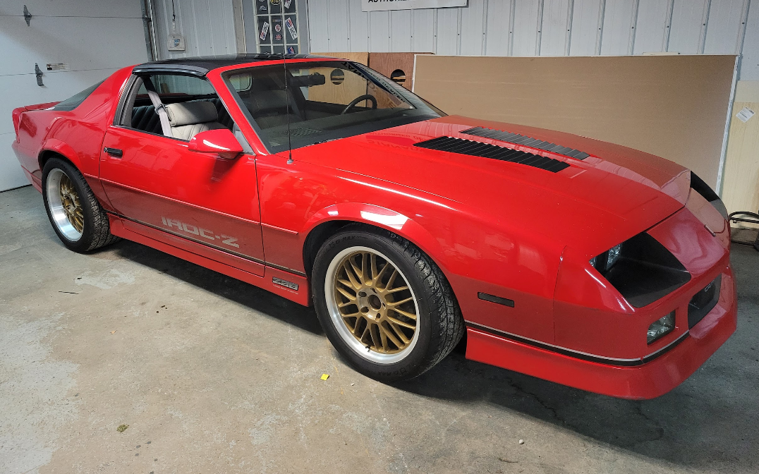

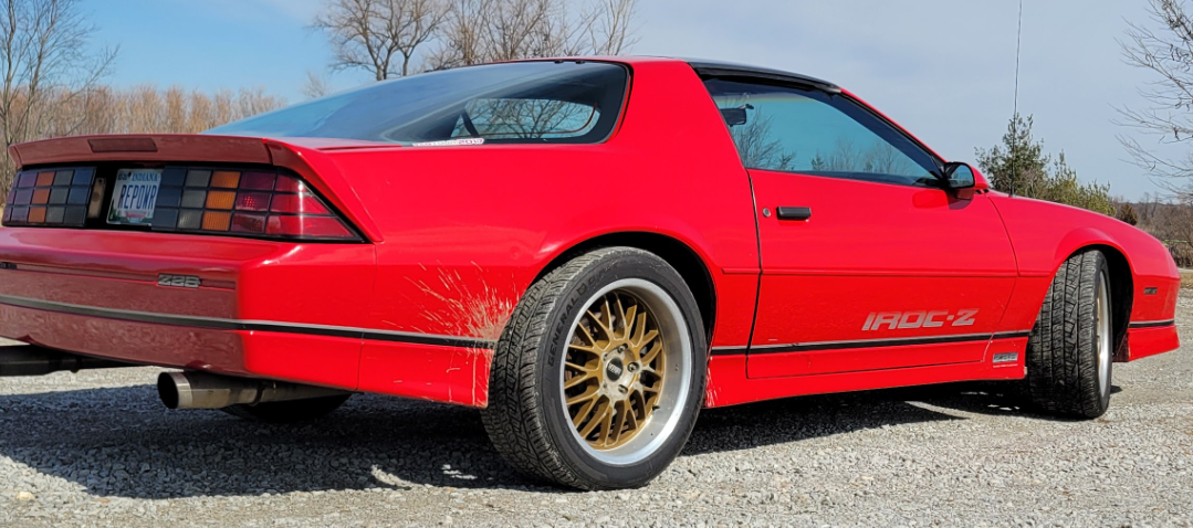

How the car sits now

Your current fit looks good. Ride height and stance too. What size are they? Being BMW wheels, they're probably 120mm bolt pattern, not 120.65 like 3rdgens. Obviously, they "fit," but for custom made, get the correct bolt pattern.
Factory front was 16x8 with zero offset. A lot of people who get 17" or 18" diameter get them 9" or 9.5" wide. The 9.5" wide people say it's the best size, but I can't say I agree. I've played around with dimensions a lot, and my own are 9.5", but, IMO, 9" wide is ideal for a larger width than 8", so 8", 8.5", and 9" will be easiest to fit with zero or small offsets on the front. 9.5" can require more careful calculations to determine an appropriate offset. For the rear, a 4thgen axle is wider than a 3rdgen axle, so a rear wheel will require more/deeper offset than a rear 3rdgen wheel. What you have on there now looks good, so I'd go with that same offset/backspace for the new rear wheels, if you stay with a similar width wheel. A little deeper for a wider wheel than you have now.
I don't often compliment Hawk's, but they got it right when they chose 17x9 for reproduction wheels, and everyone who has them seems to like the fit. They have a 12mm offset, with a 6mm spacer for the front to decrease the offset for suspension clearance, which means 6mm offset should be good for 17x9 on the front. 18x9 with something like a 6-12mm offset would be good. Play around with online tire and wheel size calculators and comparers to see for yourself. They're fun tools.
