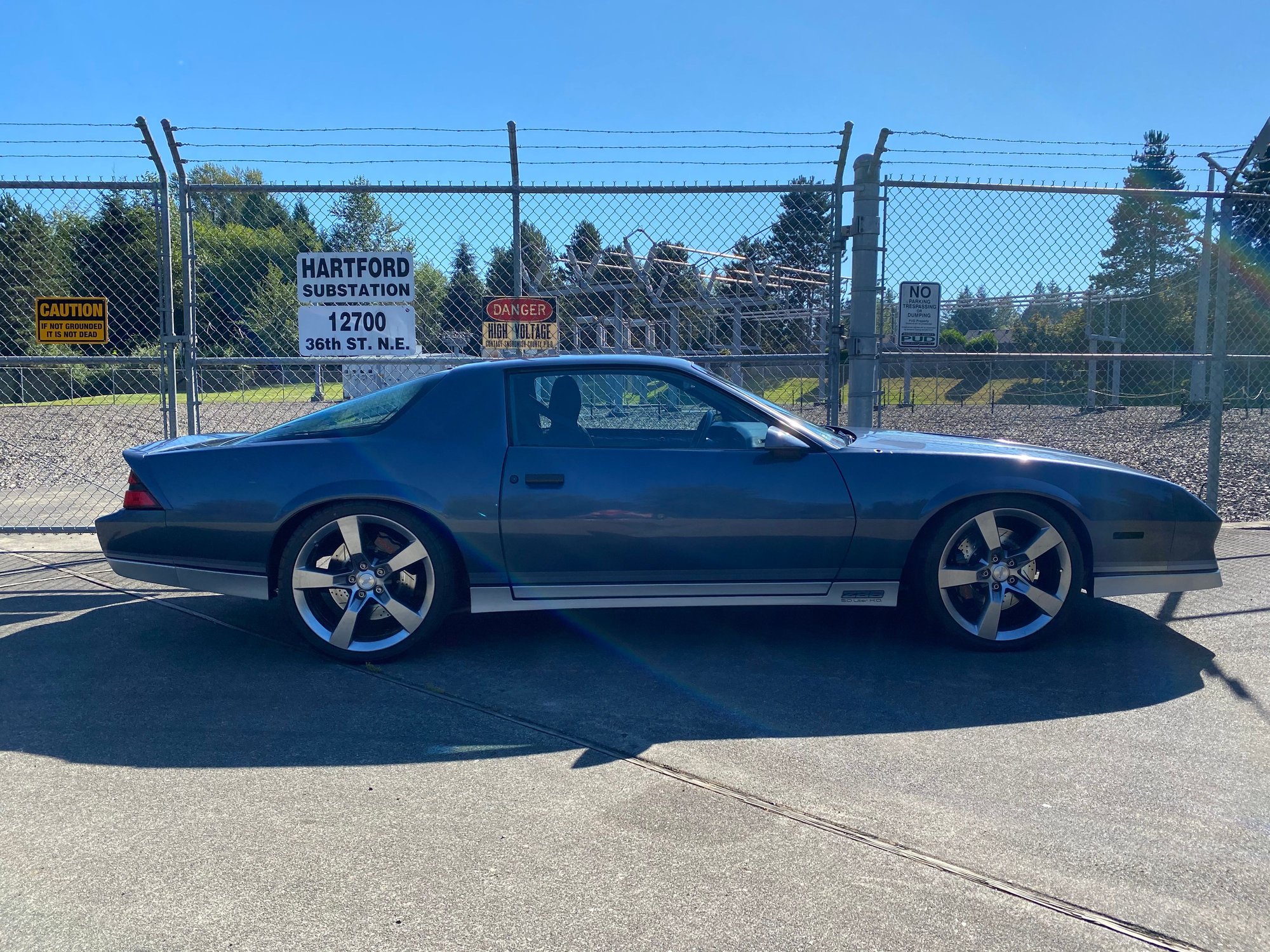

Re: Putting 5th gen Camaro wheels on 3rd gen, what adapters do I need?
The inside flange of the 5th gen wheels are 67mm, whereas the 3rd gen Camaro and Corvettes have a 71mm flange. You can enlarge the inside flange of the wheels or get flanged spacers to adapt the wheels.
