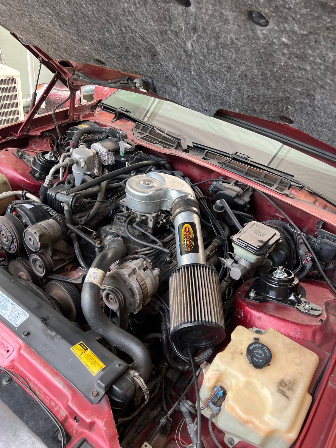

Thank you all for your comments! The parts are NIB, still sealed. I may forgo the project and focus on putting in a cam and 1.6 rockers. The engine has almost 300,000 miles. She is definitely true to the 305 name of being reliable.
I've included the parts below and a photo of my current engine bay. I was gifted a cold air intake for the 305.

That's a hot air intake but uhh, filtered air is better than non-filtered usually.
The MSD kit is more of a standalone timing setup to be paired with a carb or aftermarket TBI. You could put it on your stock motor, likely won't change a lot but you could probably get a more aggressive timing curve out of it.
Personally I'm not a huge fan of using stock fuel but aftermarket timing or vice versa, I like it all handled by the same ecm.
