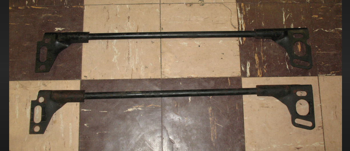

Best steering brace/wonderbar?
I've been looking at steering braces for a while and there's a few to choose from. From personal experience or even an engineering standpoint, who offers the best steering brace? Quality, performance and fitment wise. I'm leaning towards the TDS one, but if you've tried any of these, please say how it worked out.
TDS
BMR
UMI
Spohn
Or should I just try and find an original one off an IROC?

Looking at the photos from an engineering standpoint, the TDS at the top is superior in design and construction. They don't simply tack a few pieces of steel sheet to a tube, it has weld/support in a much larger area, and there are no 90 degree transitions between the bar and the brackets. Using larger diameter tubing is silly if all the stress is concentrated on the right angle where the brackets are tacked on, that will be the weak/flex point, might even crack over time. The stock piece is OK, smaller diameter tubing, but at least they didn't just tack the brackets on at a 90 degree angle. Obviously nobody at those companies stayed awake for the most basic engineering classes in college.
If price is even close, TDS is the better product.

Can someone post a photo of the factory iroc one? I would like one for my 88 trans am. What year irocs had them
I've never seen an IROC without a Wonderbar. The original is stamped (and probably strong enough for your needs), while the after market versions are far more beefy.
JamesC
Attached Thumbnails Best steering brace/wonderbar?-screen-shot-2017-05
