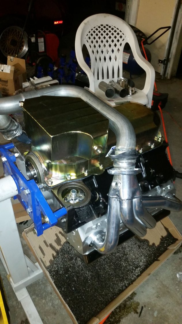

finally got my 383 in and dyno don's headers and Y fit with no issues. I don't have a under car pic but here is the mock up on the engine stand. oil pan in Canton 244T

do you have decent clearance with the starter and that oil pan? I have dons headers too and would like to run that pan but was afraid my aftermarket mini starter would be too big.
plenty of room, I'll take some pics for you tonight of that area.
That's a nice oil pan.
Most people don't have issues with the pan, if I recall most people (that) have issues with the left side hitting the frame.

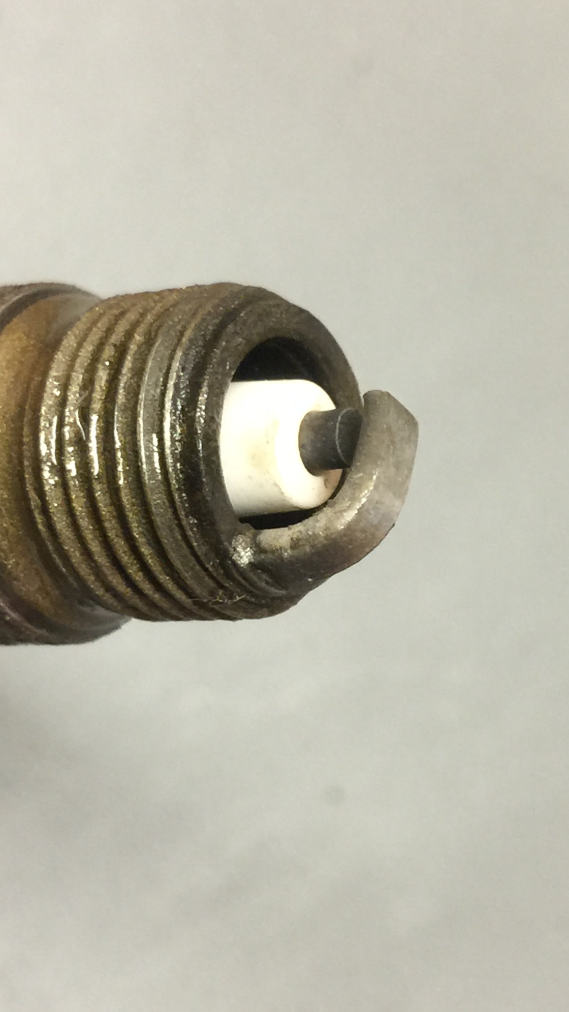

Question for those of you that have the Dyno Don headers on your car. Do any of your header tube start to glow while the holding the engine at 2500rpms or higher? I had an issue with the number 7 tube turning cherry red and narrowed it down to a bent exhaust valve. I had both heads completely rebuilt and now the engine is running like it should but while trying to force air out of the engines coolant passages, I noticed that the number 7 and number 8 primary tubes were starting to turn red. Engine runs smooth. Timing is at 6 degree BTDC. fuel pressure is at 40psi. Plugs looked grayish gold. Car is not overheating.
Do I have another issue here do will these tubes do this because of the thickness of them and material they made from added with the act that there is no airflow going through the engine while the engine is holding a steady 2500rpm for a couple minutes.

Originally Posted by IROCZ1989
Bad injector?
Thats what I thought when this whole ordeal started 6 weeks ago after I installed the headers and had the number 7 tube glowing. That turned out to be a bent exhaust valve. So, after pulling the heads and having them completely gone through, I put them back on along with a TPIS intake, SLP runners, AFPR and Bosch III injectors from FIC. I have the fuel pressure set at 41 with it idling with the vacuum line connected. its 50 or so with the line disconnected.
I ran the engine at 2500RPM for a minute to purge an air bubbles from the cooling system as well as listen and look for anything wrong. Thats when I noticed the same header tube starting to turn a pale orange. I looked at the rest and the #8 was doing the same thing.
The picture of the plug in my last post is from cylinder 7. I pulled a few other easy plugs and they all look the same as 7. I figured I would ask here since a few of you guys are running these headers. Just not sure if I have something wrong or if its just a combination of scenarios taking place that are making the tubes get hot. FWIW, I checked the temp of all of them with a point and shoot thermometer about 1" past the head flange and they were all within 30 degrees or so. The engine runs smooth and I out about 20 miles on it yesterday with no issues. I checked the headers throughout my drive and they were not glowing. I was running with no hood on the car.
Im just hoping that maybe, just maybe, the thin wall of the tubes and the lack of air flow while in the garage caused the back two tubes to do this.
What I cant have is these headers doing this in the middle of the summer while I am sitting in traffic. They will literally catch something on fire.

I really dont know. Maybe since you overheated the header tube before? How did that piston top look?
My #7 and #6 is doing the same thing and I'm pulling my hair out. I just ordered a new set of injectors to see if maybe some of mine are erratic.
I'm running stainless headers, but either way I don't think your problem is related to headers at all.
Are you sure the valve isn't too tight?
Common sense tells me it can't be a timing issue cuz it would happen on all cylinders. A fueling issue is possible if an injector is pooched, but I'm worried on my own car that it might be a valve issue.

When I did the valvelash setting, I went 3/4 turns. There were a couple that still needed a bit more after I fired the engine but those were not the #7 and 8 valves. I'd really like to pull the covers and adjust the lash while the engine is running but it makes a mess.
Been doing it that way for 20+ years. Just use cardboard, and don't rev the motor past idle.
You could also swap the injector to another cylinder to rule that out.
Like I said, I'm still trying to find mine but I suspect it's the injector. Although I'm tempted to do another valve adjustment this week just to be sure.
-- Joe
I just put new Bosch 3 injectors in this engine when I did the recent work. The injectors were bought from Fuel Injection Connection and were flow tested prior to shipping them to me. They were installed 3 weeks ago. Im 99.99% sure its not the injectors. Im 100% sure its not the timing. This leaves us with valve lash adjustment, bent valves or thin wall tubing on headers and lack of air flow to the rear tubes.
lash....could be and I will have to check on that
bent valves....no way since Ijust had the heads rebuilt
thin wall tubing and no air flow....could be and thats why Im here asking others who have these same headers.
If you held a steady 2500RPM on the engine while parked, would the rear tubes start to turn a slight silverish orange just at the bend in the tube as it leaves the head..
