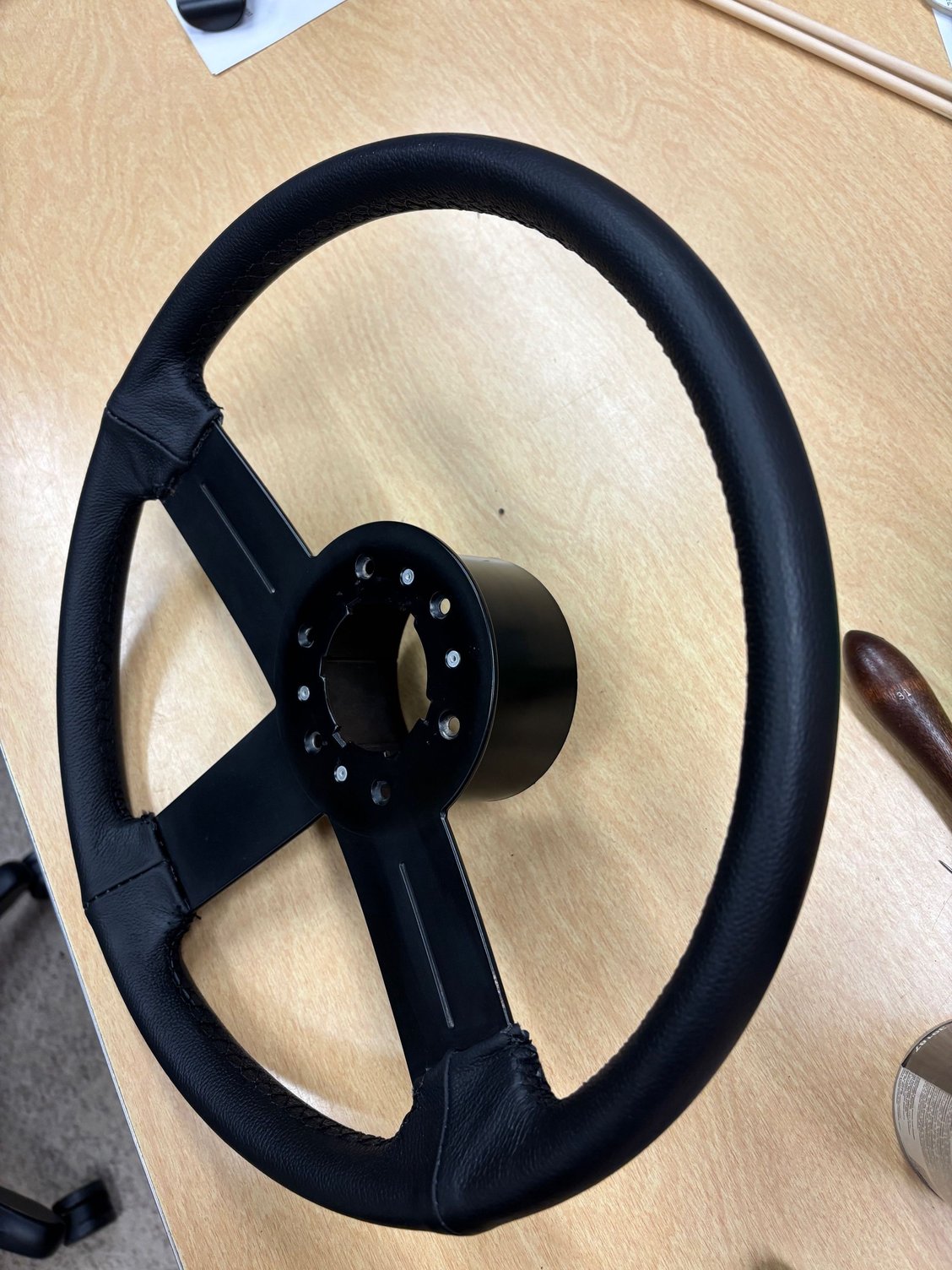

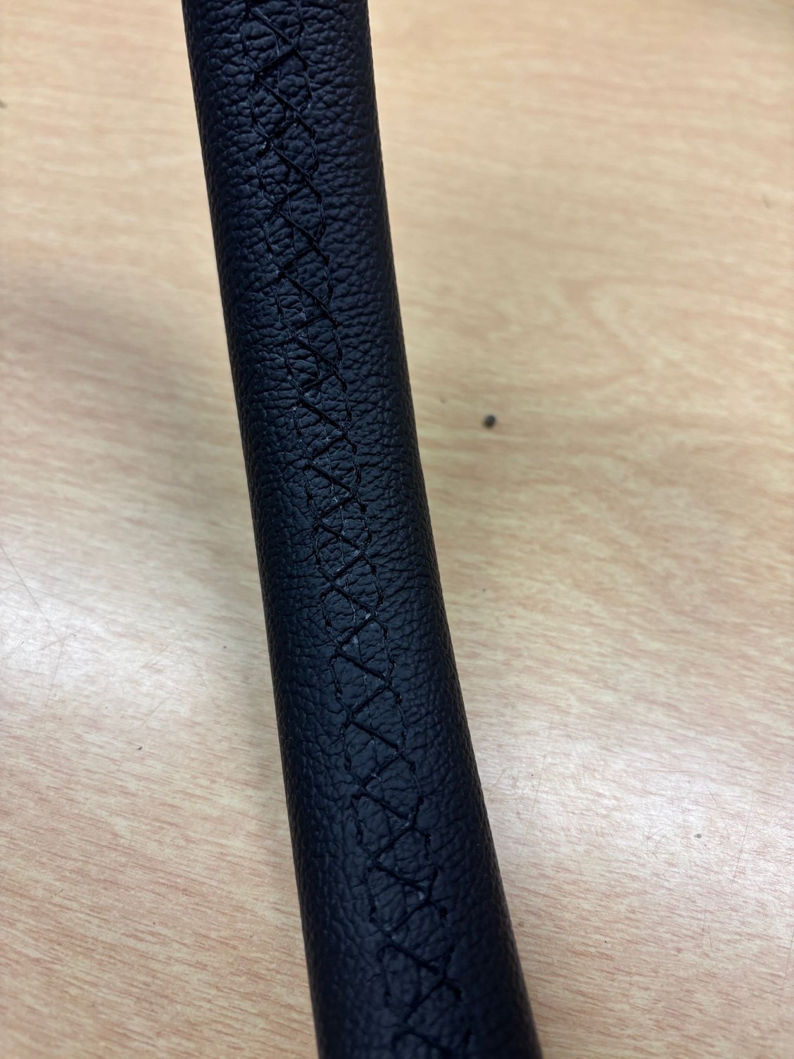

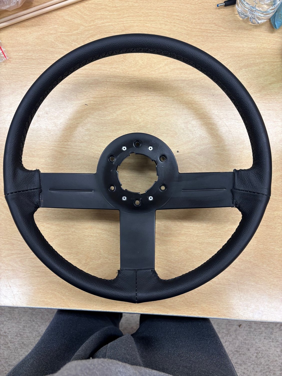

Well after a few months of thought I ordered the Redline leather wrap to install myself. The leather has slightly more texture than the seemingly smoother and thicker original but it looks and feels very nice to me. I found that the stitch pattern is different than the original; the new wrap has a sort of diamond pattern where the original is a series of Vs like a baseball. This is as seen in late model cars I have looked at but I doubt anyone will ever notice. The Redline order also offered optional foam padding for an extra $49 which I declined as I thought the original was not padded and this was probably a modern upgrade. Turns out the original did have a thin layer of foam over the hard rubber core and I probably should have replaced it but I find the new feel acceptable. The results are not perfect but that is likely more due to my install than the quality of the material and I am pleased. They offer (and encourage) their own installation service and I would say I probably spent 6 hours so it might not be a bad idea next time, Todd C

That doesn't look bad at all. I got the NAPPA leather. It's smoother, more like the original. Your stitching looks perfect. You weren't able to use the baseball stitch? When I wrapped my wheel years ago I was able to use that stitch.
Do you think the leather will start twisting like the factory did? I'm thinking the padding would help prevent that since it would wind up a little bit tighter of a wrap.
It looks like they didn't cut the pattern quite right since the side seams wound up slanted instead of straight across.
I haven't sent mine off yet.

I think in daily use it might be possible to twist (as my original was) but in my hands it won't be a problem. If the seams are off it is more likely my fault then theirs, they were a tight fit with lots of pushing and pulling
