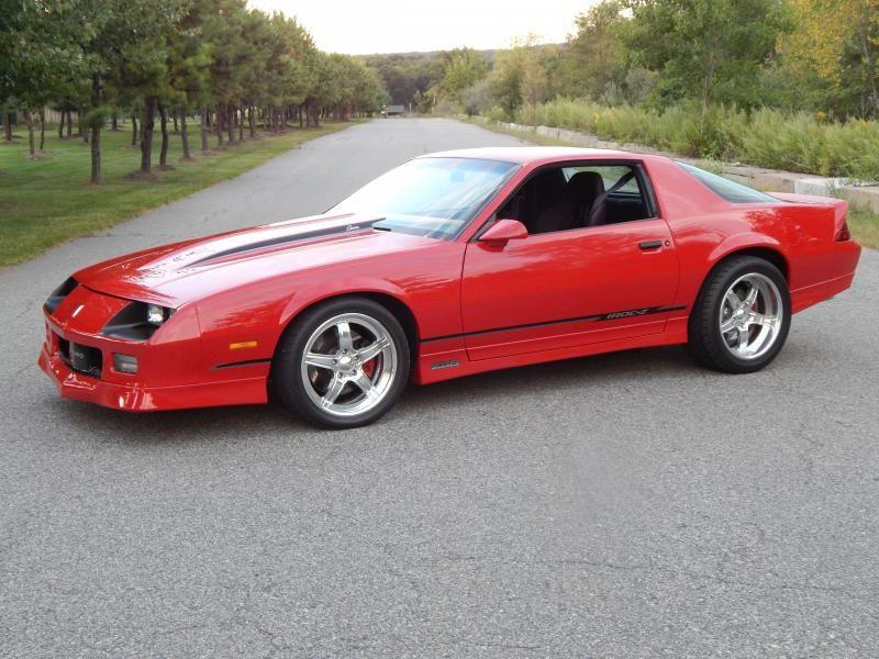

spent time looking for a hood that was made like the one I have now.(3" tall) wanted more room.
bolt on
open on the underside.
framed only on the outer edge underside for the bolt on.
and laid back toward the window.
5 to 6" tall
will do a post on fit & finish.
as long as there is no damage when they deliver it. have to open inspect before I sign for it..

RamIt, I've always loved the 2" Glasstek as well. Fave aftermarket hood. ...still not as good as functional louvers though!!!!
...but you know...if you need the clearance.

you made a GREAT choice going with the Glasstek hood. That is actually my red camaro posted up in post #2 byRamIt. I had that hood put on the car in 2004 or so. I don't remember what it weight in at, but the quality was amazing (and it still is) after many years it has been great. I got it over a Harwood on the advice of my Painter, who showed me some of the Glasstek hoods on his pure built drag cars.. and I like the look of the longer lip above the cowl.
Ironically, for the first time in about 7 years.. I took the hood off the car JUST LAST NIGHT ! strange coincidence. I took the hood off so it is not in the way, and does not get accidentally opened/damaged into my garage ceiling rafter beams, while the car is jacked up 2 feet in the air next week when I pull my current (exploded) transmission.
Mine is a bolt on as well. used stock hinges, but painted them up. Decided to put the "popper' hood spring on the font nose of the car instead of mounting it on the underside of the hood as I did not want it to cause stress or crack the fiberglass in that area of the hood. many years later, it has worked perfectly. The quality and fitment of the hood is dead-on perfect. glad you got one, the 5" will go way better with your car for sure.
