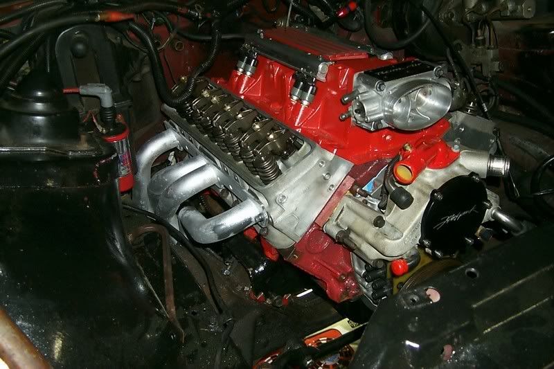

anesthes, nice set up, but we need to talk about your ignition wire routing. Seriously, if you have the same problem as me, burning wires on the headers, I would recommend Design Engenering Inc. heat sheath(?). I use them on my two headered cars with no burnt wires in three years. Elsewise, I think you got it goin' on.
Rob
Rob
I've never had a problem with burned header wires on my fbody cars, but the headers on the vette run a little differently. I was gonna get some slip on boot covers to proteect them.
-- Joe

Joe - I'm kinda surprised you got a coil in the cap dizzy to work, too. Figured a small cap was required.....
A small cap or screw on coil in cap works, the clamp on style coil in cap won't clear the rear fuel lines out of the miniram (i tried). the screw on style is like literally 1/4" narrower and clears by like 1/8". heh
Some stuff on the vette is crazy tight, you should see the oil temp sender and gauge sender on the back of the block, which is also 1/8" from the dizzy and 1/8" from the wiper motor. Other things however have tons and tons of room.

Ah, I see now. I don't think the dizzy fitting or not has much to do with it being a Vette though, its all the LT1 or MiniRam style intakes and the fuel rail locations, right? I wouldn't want to try and fit a large cap with my SR either....

Originally Posted by anesthes
Current setup. Need a longer rubber boot for the throttle body though.
What valve covers are those?
Stock fbody covers for a pre 87 TPI car. I wanted to use the cast vette covers, but the rockers wouldn't clear. These clear the trickflow alum rockers.
-- Joe

Really? are they steel or aluminum? I like how those look and have been looking for parimeter bolt VC's... I definitly like the cast 'vette ones but I suspected that they'd be tight, I keep hearing that they'll work with double gaskets but I haven't found a set of them anywhere either.
Those are stamped steel. Pretty much the same as the centerbolt ones, just parimeter. I've tried a lot of covers over the years, and the OEM baffles are just the best.
The cast vette covers have these stupid tabs cast into them that hit the rockers. I guess they could be cut off, but i wasnt in the mood to try it and then have a tap later on.
-- Joe

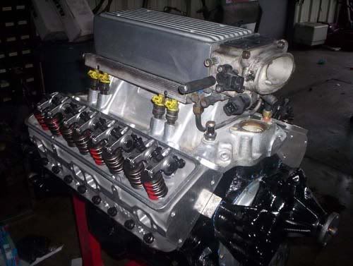

The 1.6 roller rockers (crane?) that come in the hot cam kit will fit the vette covers once clearanced.

How about the Comp 1.6 steel Pro Mags? I think I've got a link somewhere that shows a bunch of grinding being required...
Yea, they’re the same as the crane golds.
They’ll work under the composite center bolt covers, it’s a fairly common thing to do with the LT1 4th gen guys
The pro mags are a tighter fit then most of the others… I know that they don’t won’t work with the stock breather baffles and the inner valve cover supports without a bunch of cutting

Here are some pics of the stock valve covers from a 92 vette LT1 engine after modification (and a few cold ones)!!
Attached Thumbnails Post Your Alternative Port EFI PIX???-vette-vcover1.jpg   Post Your Alternative Port EFI PIX???-vette-vcover2.jpg   Post Your Alternative Port EFI PIX???-vette-vcover3.jpg
