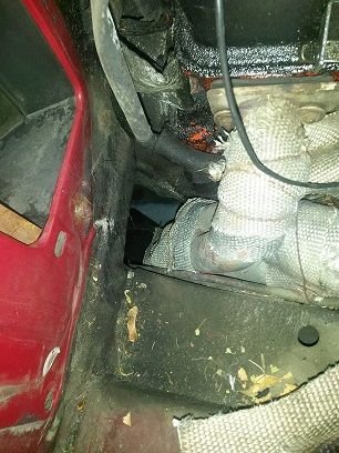

I suspect I may have a problem with my fuel getting too hot. I figured since I run HSR this would be the appropriate place to post this but it could apply to almost any car.
After a long run, especially in hot stop and go traffic, my car starts to run rough and stinks more. (the exhaust always smells a little of raw fuel but it gets bad at times) I have been trying about everything tuning wise to correct it and yesterday when I parked and opened my door I could hear gurgling. I thought it was the cooling system at first but it was coming from the rear of the car. I opened my gas cap and it got louder. I sounded like bubbles coming up through the fuel. Could this be causing my car to run poorly when hot?
I have full, stock metal fuel lines with adaptors up front by the power steering pump then it changes to rubber lines which route around to the back of the motor by the distributor. I have headers which are about 3-4" from the lines in the engine compartment and have routed the drivers side exhaust straight back past the trans so the front muffler (next to the trans) is 2-3" from the fuel line in that area.
I am wondering if the constant circulation of fuel and the close proximity of the exhaust/fuel lines, not to mention the fuel rails right on the manifold, may be heating up the fuel to a point where it is somehow affecting delivery. I have noticed that AFR goes up (leaner) when it gets hot and the problem seems worst.
I am considering some heat shielding of the fuel line where they are close to heat sources and possibly re-routing them all together if necessary. I don't know if there is anything I can do about the heat picked up at the fuel rails but it seems a "parallel" circuit at the rails may pick up less heat than the current "series" circuit. Any comments or ideas are welcome.

Re: Hot fuel causing problems?
Check your fuel line location. Mine is a 1982 Trans Am, and I never knew the line was this close to the header until I pulled the A/C box off the firewall.
It never really had issues in the 1990's, but the 10% alcohol in the gas today seems to make a world of difference.
