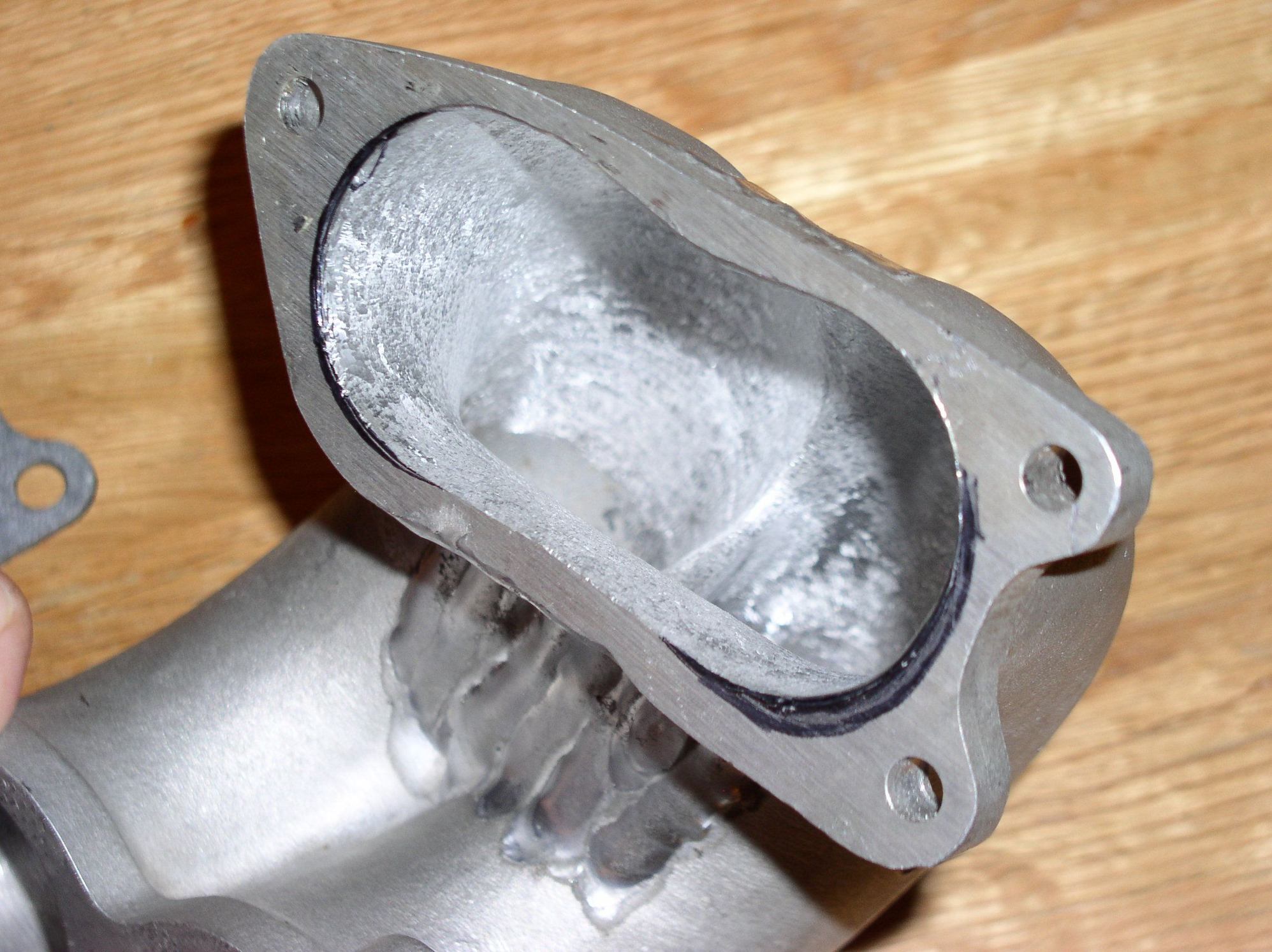

Read what 1989gtatransam did with a first base and custom bigger tube long runners. It made power and rpm
He did essentially the same thing I did, just 10 years later, and makes about the same power I did. Then I switched to a singleplane and picked up another 10 MPH in the 1/4.
And I wasn't the first person either to hog the crap out of an aftermarket base, and modify some SLP runners, and siamese a plenum.
I think I did my first singleplane in 2002 after getting fed up with aftermarket TPI.
If you're restrained by the smog ****'s of California like he is, then that is what you do.
When did you make 420 whp naturally aspirated with a long tube runner 10 yrs ago? I call bull
You say its no better than stock tpi then claim to have done something on the level of fairly impressive numbers....which is it?
I have no idea what the whp was, I just know what it trapped for MPH.
It wasn't naturally aspirated, it was blown, but it was a POS long block compared to his. His motor is a 368 with AFR 195 heads and 11:1 compression. My combo was a 350 with iron world heads and 8.9:1 compression.
His combo and mine ran about the same MPH in the quarter. His combo and mine both had an aftermarket base which was completely hogged out, modified SLP runners, and a completely siamesed plenum.
Then I changed just the intake manifold and it ran 10mph quicker.
And that was my whole point to begin with. TPI is a waste of time.

I’m really glad Ken from FIRST has joined the board. He’s right on with his comments. There is no fixed runner intake that is best for all applications. The problem with intake selection for the old school SBC is the runner length selection is rather limited and there STILL isn’t a good out of the box “middle of the road” runner length with proper cross-sectional area available.
One of the reasons the LS engines perform so well is the intake’s runner length is around 10” with a cross-sectional area of around 2.7” (which is about 1.85” in diameter). That’s an excellent length and diameter to provide a considerable “tuned” midrange boost while still allowing good upper RPM power in the 6000 plus RPM due to the LS head’s cross-sectional area and flow. There isn’t an out of the box SBC that comes close to it.
There are SBC heads out there that have similar cross-sectional area and can flow as much or more than the stock LS3 heads. If you look at single plane LS combos compared to single plane SBC combos with comparable heads and cubes, there’s not a lot of difference between the two. Where the LS engines really shine is when the heads are fully ported or a stock type long or “tuned” LS intake is used. When running a stock style “long” runner intake, it’s almost impossible to match the power curve and RPM power band of an LS engine with a SBC of the same or close cubic inch displacement.
The FIRST is the only intake available that I know of that can be modified to get close to an LS style intake power curve with semi-extensive effort. The cross-sectional area of the FIRST’s intake and runners can be ported to 2.89” (more than a stock LS3 intake) and if you weld up the center runner creases and siamese the runners as far down as you can with a 6” burr, you can get an effective runner length within a couple inches of the LS intake. Here are a couple pictures of what I started a few years back and hope to start back up and finish within the next 6-months or so.
Welded creases
Extensive siamesed porting
If Ken comes out with a runner with the creases filled, or at least the bottom side filled, one could do pretty much as I’ve done without the added aggravation of having the current runners welded up. I’d rather see that than a 2” runner because you really don’t need near that cross-section area (3.14”) on 90+% of streetable SBCs. I’m planning a very healthy, near max effort 406 (for a long runner combo) and all my modeling says I need something in the area of 1.88-1.92” runner diameter. Any more than that and I’ll lose more midrange than I’d gain on the top end.
Ken, if you offer a runner of around 1.85”diameter siamesed about 2” down from stock that would work extremely well on larger cubed combos. It would also save folks a heck of a lot of time if they wanted to siamese it more, or port it to a little larger diameter. It took me a heck of a long time and I seriously lost feeling in fingers on both hands for few days and took about a week to get full feeling back after I finished siamesing and porting the runners - lol.
That is awesome work badss! And I know about the numb hands, been there done that too! In the beginning I used to offer that service, not so extensive though! You are also correct about the sticker shock if you were to charge for all that time! It is funny that you bring this up, as that is what I have recently geared up for! I purchased new flow testing equipment so we can get flow numbers on each level of Siamese work also. I was actually going to flow every inch just to see the changes. I am totally up for changing the patterns to add some material so that there is still a parting line, but yet enough stock to do the Siamese. This is as soon as we get caught up! I do plan on writing a program to incorporate an actual CNC version of the Siamese runners with our 5 axis CNC. I figure you are probably spot on with around 2" down for being the optimum length. The reason for the 2" diameter is really 2 fold. I wanted that diameter for our big block FIRST version that we have been trying to finish up here, so I figured why not be able to make it work with the SBC one while we were at it! Maybe I split the difference and just go 1.9"? But testing will confirm that I guess? We are shopping for a dyno so we can actually not only flow test these different set ups, but do live testing as well! I plan to do much of this work throughout the winter. I plan on locking myself in the shop until I get everything finished up that I have had to put off since the fire! Even if I have to have them plow snow in front of all the possible exits, so I can't get out!! Everything requires time, which I am very short on! Believe it or not I put in 12-14hr days 6 days a week (VERY UNDERSTANDING WIFE!) and I still do not have enough time! I also want to THANK YOU for actually giving me input, I really encourage anyone to throw out ideas. This is how a guy can better things, by actually listening to people! Nothing is set in stone and I embrace change and new ideas!
