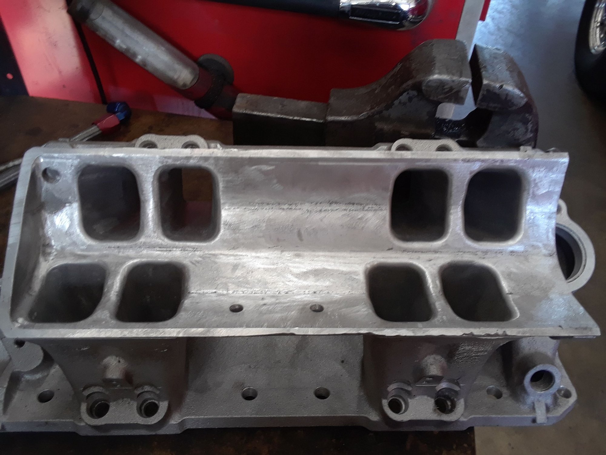

Some of you may remember me threatening to get my hands on one of these new EFI tunnel ram intakes from Edelbrock. While I had some delays getting here, I did finally get my hands on one late in November.
As promised, I have cut the plenum top off and am in the process of working the runners and plenum over. The XT is already a pretty decent intake. If you were going to install it on un-ported heads you would be best to bolt it on as cast. This SBC version (p/n 7137) appears to support around 420-440 hp at about 6K rpm out of the box. For my purposes, installing it on ported Twisted Wedge G2 heads with a ZZX cam, it deserved a little attention to make the best of what is a very good design. EDIT: The 420-44hp range is from a 350cid with good aftermarket heads and matching cam. One installation on a 383 resulted in 460hp and 506ftlbs torque with an as cast p/n 7137.
I have heard concerns of the runners being too thin to allow porting to Felpro 1205(2.09 X 1.28). I myself had the same concern when I first looked the piece over. After opening up the plenum and going to work on a runner, I will state here for the record that these concerns are unfounded. There is plenty of material for at least the 1205 runner size. From my measurements, there is still a good 3/16" of wall at the thinnest point on the ported runner.
The as cast runners measure 1.99 X 1.49 at the entry. You can see in the photo the difference between the 1205 gasket and the runner exits.
The ported runner entry measures 2.10 x 1.60, an increase of about .100" both directions. This I've done to match the increase of the runner exit to the 1205 dimensions, maintaining the original taper between entry and exit. As you can see in the photo, I've stopped just a hair short of the full 1205. I may leave the exit there, aside from some detail work and finishing, as there is a minimal affect on flow from this small difference(about 1/16"). This way, I'm covered for alignment of the intake to the heads.
The large protrusion of the injector bung into the runner is another issue. I was going to install Bosch IIIs, which are 2.5" long and would have sat deep in the bungs, not allowing for much if any trimming. I decided instead to go with Edelbrock injectors that are 1.15" seat to seat and will sit against the top edge of the bung with only the o-ring and a very thin retainer sitting in the bung. This should allow for alot of trimming on the bungs. I'll have the injectors soon and then I'll finish the bungs.
For now, here are some progress photos.
