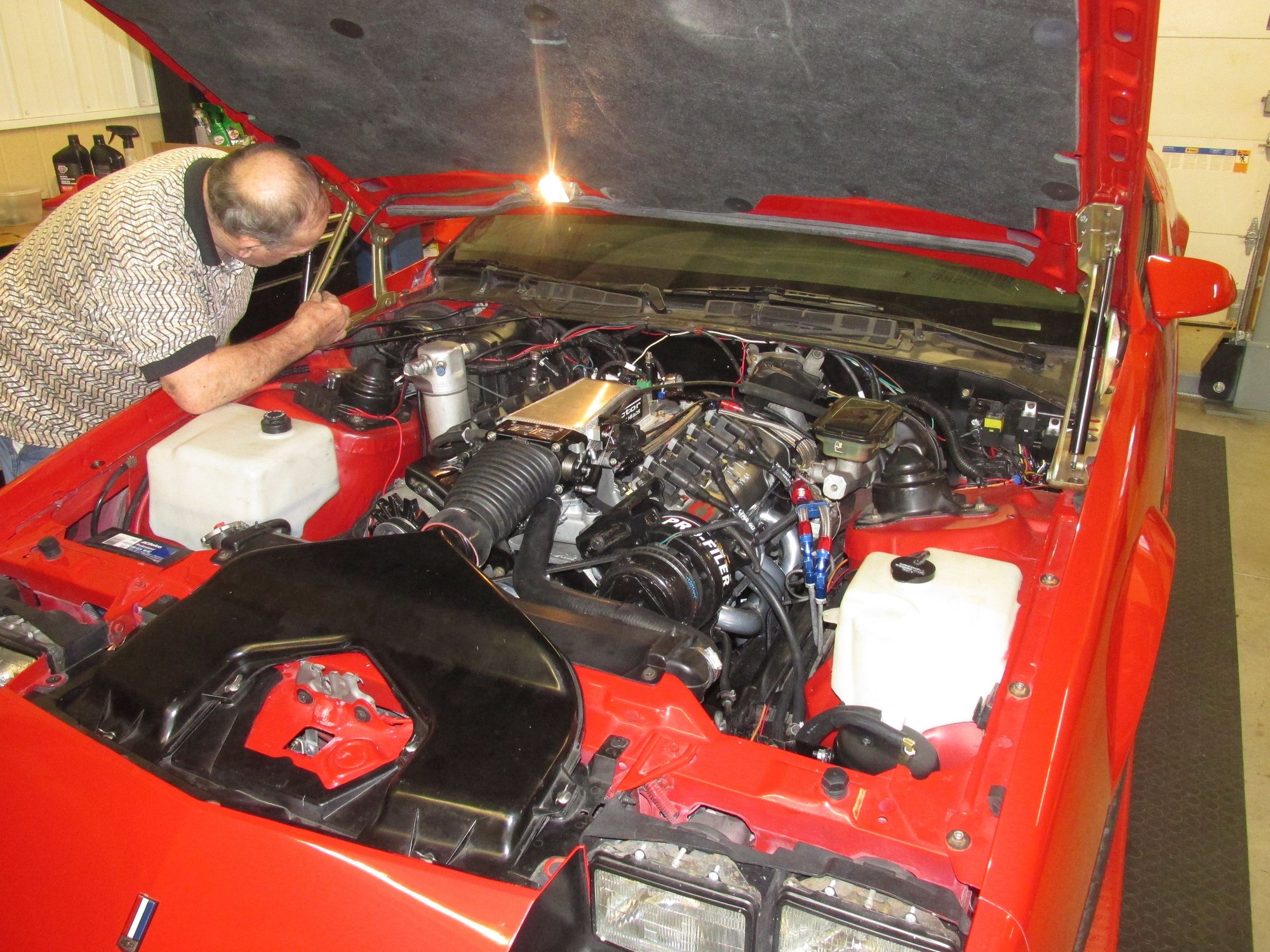

Now the real fun. Getting the HP wired and fix what doesn't work because I pulled a ton of factory wire!

Re: My Alternative build
People wondering if the hood would close. BIG RELIEF!
NICE JOB! that is going to be a ton of fun
