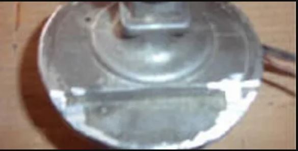

From the installation instructions:
On large cap H.E.I. distributors you may have to remove some of the casting on the bottom of the distributor to allow sufficient clearance and for timing adjustments.
They used to include a picture in the older install manuals - luckily they have a blurry picture of where to grind on their website.
Before I put on the FIRST I had a HSR that had to have a small cap distributor - so I used the small cap HEI on the FIRST and it fit nicely.
HTH
