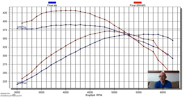

SR vs Mini ram on a stock LT1 in dyno trim SR in red

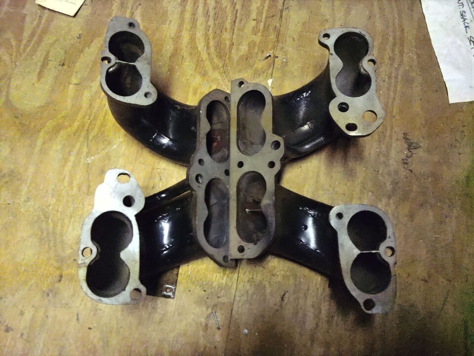

Here is one with the tanks modified and runners cut back
I have one that has runners cut back as well. The center plenum area with runner intrusion right behind the t-body has always bothered me along with plenum volume(is it enough?). I have pictures of a hawk with the throttle mount raised a bit to get more air over the front internal runners. If you look at the firehawk vid from slp really close when they pull a side tank off, you'll see its been cut back about 3-4 inches.

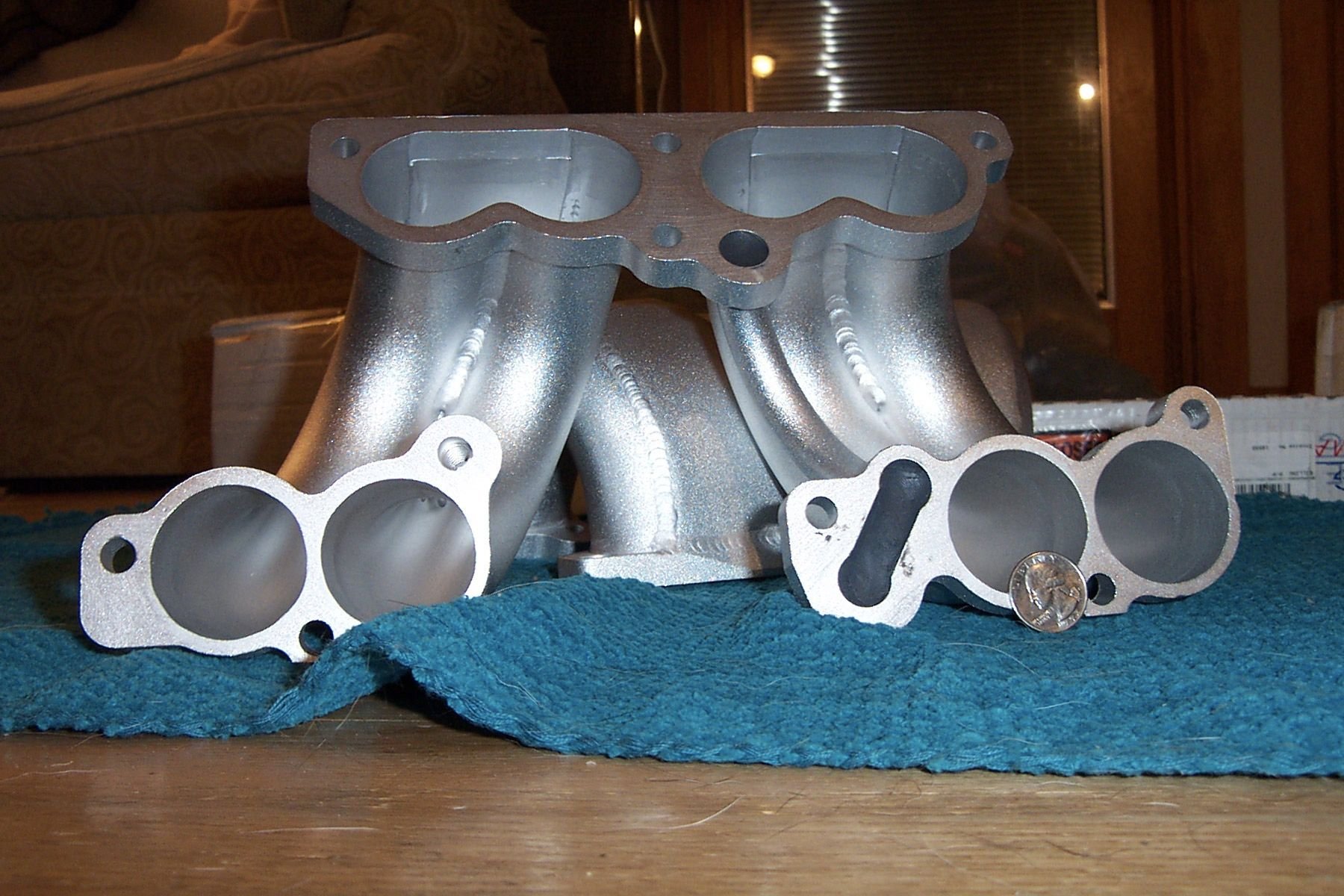

We are on to round five I sent Tom siamesed runners and matching plenum to test a "poor mans" super ram, this was very popular where cast runners where ported with various different divider lengths many would go to great lengths to hog out there runners. This set is imo max effort with out welding, the runners are a pair of siamiesed AS&M runners that used to be sold through them. This set was chosen bc the AS&M runners are the best out of the box runner available even to this day with a near 41mm inner diameter runner with no protrusions to speak of as seen on cast runners, this is the same size as the SR runners only difference is the SR expand almost to 43mm at the entry. The plenum was port matched to the runners almost perfectly and the throttle body entry was set up for mono blade to increase what ever plenum volume can be had with the small plenum.
To get this out of cast runners would be a undertaken bc its very hard to open them up to 41mm near the center and certain areas may need welding where they cast indents into them for the TB coolant line and clearance for the bolts

T ram, SR, and siamesed runners, I dont believe the test went to the extents I did with there porting, what is interesting to note is how close the three are yet how different they are physically with the siamesed set producing slightly more power than the T ram at 5300 and below

I've always wondered why the peak is left between the runners on bottom, the peaks inside normally at top and bottom (on siamesed runners.)

The peaks in plenum and on runners between the ports after cutting out the center wall. I know it's more work to the gasket surface on the outer plenum to make the paired runners 1 large oval.
The intake you have pictures of shows the peak on the lower side of runner inlet but not the upper.
just wondering if it helps at all removing those peaks completely

oh yes the ridges, that is a older pic that lower nub has been removed since then and the other ridge wall that separates the runner pairs has also been dialed back
my theory is that i need to remove anything i can from the plenum to gain volume because its small to begin with the other theory is that the air is moving from front to back those peaks ridges would act like flaps/walls causing turbulence to the air flow
I had a little more work finessing to do with the plenum removing and cutting down some of the bosses but ran out of time I wanted to test runners before Tom ships the base back but I do have a belt sander and with that you can remove and go to places you cant with carbide burrs. Those are my personal plenum and runners I do plan on completely removing the bosses welding them and using shorter bolts but for testing purposes I just wanted to simulate what the average joe can do

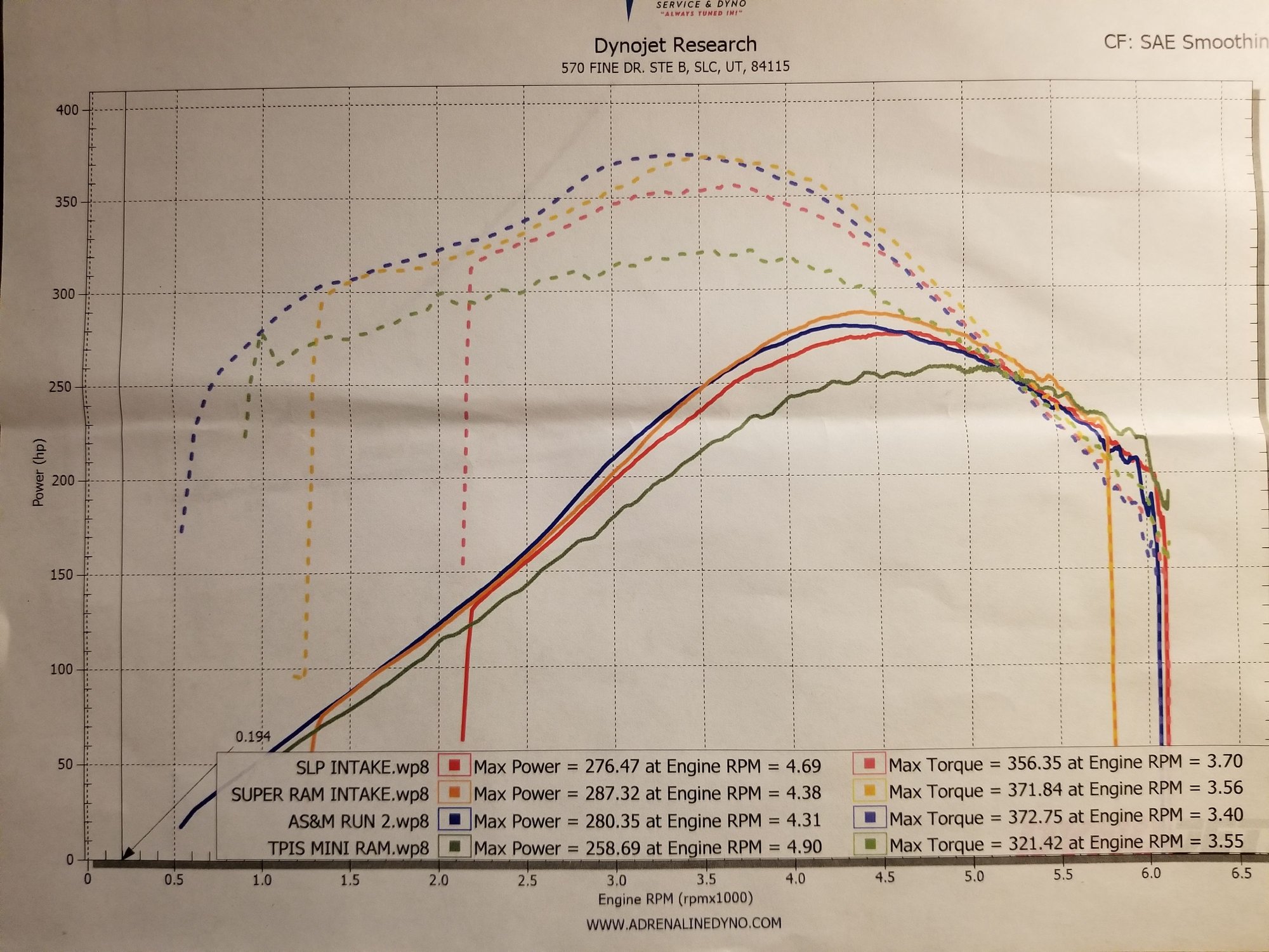

Hi everyone. I should have posted an update yesterday, but I was out of town over the weekend....long/holiday weekend here in UT, thanks to the Mormons! Anyway, got back late Monday night and the next test victim, the AS&M runners had arrived in good shape. I MAY go out of town this weekend, if not, I'll swap the upper parts and make an another appointment.

I appreciate the effort and reporting of your dyno results. It’s been extremely interesting and informative.
As I understand you’ll be testing a siamesed runner intake next and possibly a FIRST intake?
Would you happen to have an estimate on when you’ll be able to dyno the siamesed intake? I’m really interested on how that’s going to work out compared to the large tube long runners.

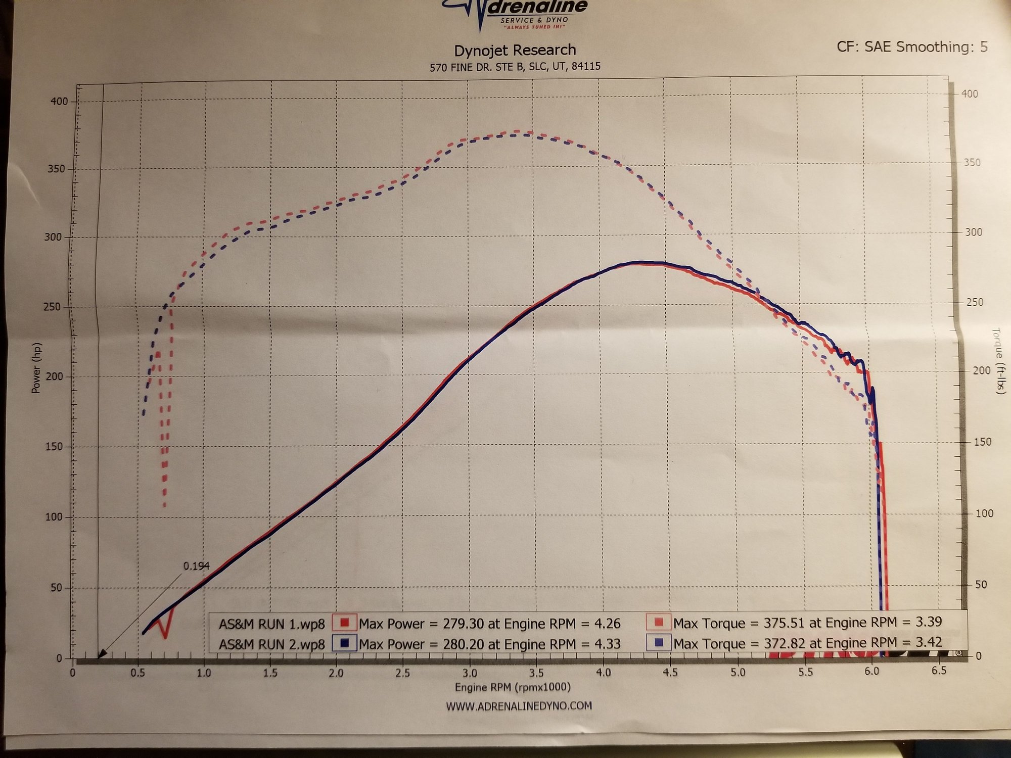

Next intake is finally on, the ASM siamesed runners, commensurately ported TPI plenum and Accel base.
I have a problem though, and maybe I just didn't notice or pay enough attention assembling, but here it is: I have a massive vacuum leak. Both side runner assy's seem to be the same, and they both have an EGR pipe. The driver's side EGR pipe doesn't align with a flange on the plenum, so it's open to atmosphere, below the plenum. Vacuum leak. I can look at it again in the AM with fresh eyes, but I'm thinking that I may have put the wrong runners on the wrong sides? Maybe?

Done...finally... the fifth pull is complete.
How'd she do?
I expected it to do worse than the SuperRam. BHR may disagree but that's what I was thinking. I was a little pessimistic and I was thinking the number would fall somewhere in the mid 260's, I was "feeling" 264. I got schooled, in that respect.
Here is where everything landed. Later, I'll post an image of all of the pulls so far, overlaid.

Great numbers thought it be close but not that close, torque is identical with the the super ram

Wow, thats really cool, power numbers so close to the SR without all the SR install headaches.
I've always wanted a set of those runners

I put this together for Tom.
Cut - paste - distort
It's not perfect but should help compare these graphs.
Some are so close.
The Siamese torque peek was blocked by a graphic and missing.
*** Update just a little more accurate match on graphs

Thanks for yet another great effort at overlaying all of the tests!
BHR, True about the tq being the same as the SR. Something holds it back a little, up...."top". ...compared to the SR. It's a good intake though, it works, way better than I thought it would....2nd best intake so far. It really surprises me how none of the intakes, other than the MR have raised the hp peak much. The AS&M peaked 100 RPM higher than the stock TPI, if I have my numbers right in my head. I'd have thought that w/the shorter effective runner and the larger cross section, it (and the others w/similar features) would have really driven up the RPM range, but the cam, heads and stock "headers" must really put a cap on things. I wonder how much just the exh manifolds are limiting things? My guess is that they're the worst part of the system, w/all of these better intakes.
I'm so glad I was able to get this done before weather. Driving it down Friday AM....it was freakin' COLD! But it turned into a nice day, session went great and everything was good. Time to pull it, box 'em and ship 'em. Thanks a BUNCH, to BHR for the loaner, killer intakes. The MAN! W/o his generosity, this data wouldn't have happened.

Here is the run, w/o the text box blocking the tq peak.
Here is the overlay. Unfortunately, two things are botched with this overlay:
1. The stock intake pull isn't on there, since I had done that original pull at a different facility*
2. The Super Ram curve is not the best one (from the super ram day). All of his files were a bit jumbled, mis labelled, so I was ID'ing them and we were re-naming them, by memory. Anyway, somehow I/we identified the SR correctly, but it wasn't the SR's best pull. So numbers on the SR are a little lower than they could/should be. Anyway, here it is....

Just picked these up, (thanks for the tip Brian). These are made of steel, haven't done any measuring yet other than the short side is 7 an 1/4 long.

Holy geezum....someone put some work into those things! They ARE super cool. Nice score.
