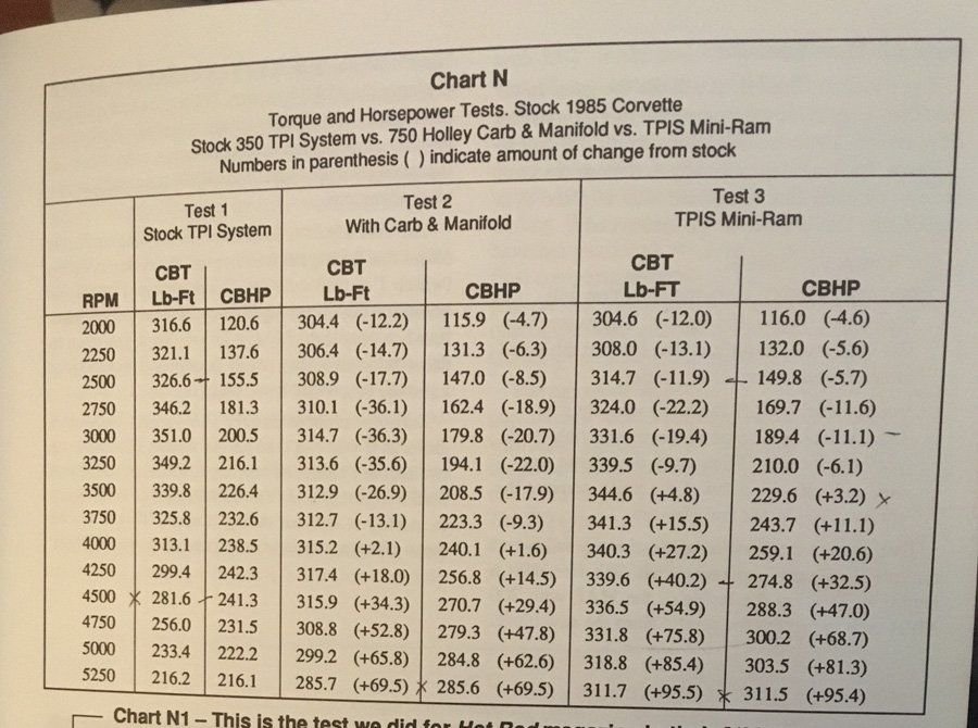

....on a stockish, L98. Yeah, yeah, yeah....there is the "10x the tq" article that has made the rounds for decades. Great article, but that test engine was too far from stock to be very relevant, IMO.
And then there was the Summit Racing marketing literature. Claimed "broadest tq curve" of any intake, and "46hp over TPI". Was that true? Maybe...that is a LOT. Was it true at some RPM way past the TPI's peak? Maybe, and that's not exactly fair or forthcoming. So, for the past 30 years, I've always wondered. I finally bought one, had a stock(ish) L98 ('89 'Vette) engine to try it on, so it was time to find out....."What'll she do?"

I replied to this earlier and said,
"260
I think the T-Ram shows "whats left on the table".
By 260 I meant 260 RWHP. On the 'Vette forums today, someone posted this old dyno comparison from the early '90's comparing a stock L98, L98 w/a dual plane and 750 carb, and a MiniRam.
As expected (by me, at least) the Carb did 285 crank so I'd say my "260 wheel" guess was pretty darn close. Also not surprising to me, is that the T-Ram (and the miniram) handily out performed the carb'ed intake pretty much across the board. :thumbs:
