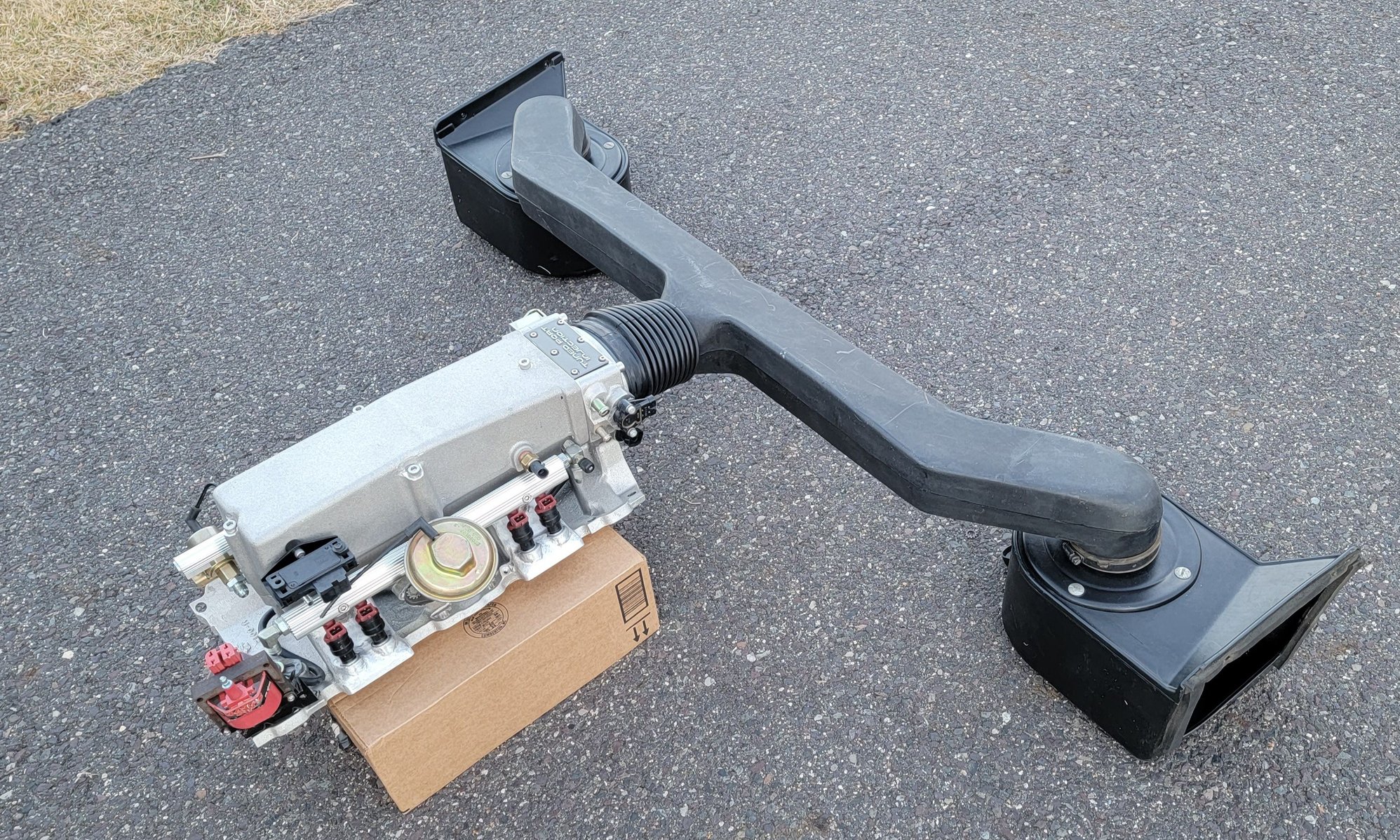

Picked up that McFarland intake that has been for sale forever. What are some fun engine combinations that would complement this intake?

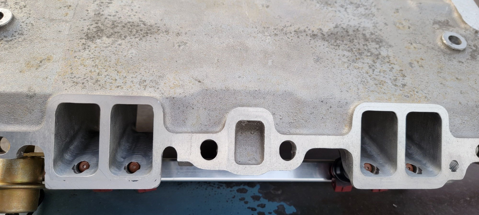

That was for sale since like 2020 im surprised it took so long to move it I've sold complete superrams for more than what it was last priced at nice to finally see more angles on it looks like it was modified to fit raised port heads or a 1206 gasket dont know if that would clear the thick vette magnesium valve covers. If you get a chance can you post the runner length? From the old sales pics the angles were bad it looked like 3-4 inches but from these angels they look much longer like 5-6
Great buy and enjoy the intake

You are correct, it was modified and ported to 1206 gasket.
Runner length is 4.5
