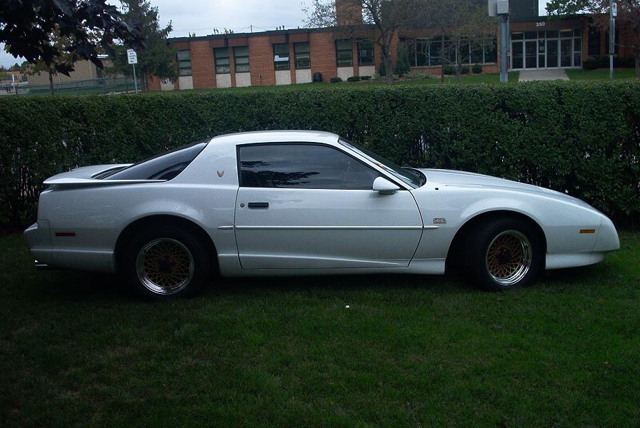

Thanks again guys for all the help, I learned alot from this. You both gave excellent points to consider and I do welcome all your input. I got the kumho's installed and they do feel good, the car handles alot better considering the condition of the front's.
That's a pic of the car just to give you guys an idea, but I will get some better pics when the weather gets better around here.
