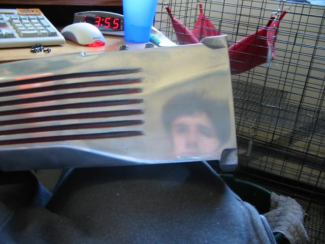

polishing problem
ok i sanded/and finished polishing and it looks like crap, what did i do wrong, do i need to resand with 400 wet or what.
my process:
150 dry
320 wet
400 wet
hard emery
soft emery
hard tripoli
soft white rouge
here are the pictures in that order, ill name them as they go.
^sanded before polish
^ emery hard
^emery soft
^tripoli hard
^white rouge soft
^ another whtei rouge
but this is the strait on finish is.
Old Apr 6, 2003 | 11:43 PM
Dan88IrocZ's Avatar
Posts: 909
From: Pittsfield, MA
You wont get anything NEAR a 'glassy' finish unless you use a much much higher grit sanding paper. Preferably wet sanding too...

Old Apr 6, 2003 | 11:56 PM
MetalliCamaroRS's Avatar
iTrader: (15)
Posts: 8,030
Car: 1989 IROC-Z
Engine: 383 stroker
Axle/Gears: Moser 9", 4.11:1
False
120, 320 wet, 400 wet, then compounds
I would try sanding for longer with each grit until its smooth.

Old Apr 6, 2003 | 11:58 PM
joshp14's Avatar
Joined: Sep 2002
Posts: 1,834
From: Norwalk, Iowa
go over it with 400 wet again. you really can't do too much of 400 wet...thats the secret step...the more 400 wet u do, the more it will shine. same with tripoli, you really cant do too much.
Mine looked like that when i first finished, but i rushed it. You have to take your time if you want it to look brilliant. Go back over it with 400 wet for another 20 minutes or so then buff again. Also follow 85SportCoupeto89RS's advice.
And yeah...don't go above 400!! It will cloud if you go above 400 cuz it glazes it over and then u wont be able to clean it up.

Old Apr 7, 2003 | 12:08 AM
85SportCoupeto89RS's Avatar
Posts: 2,760
From: Cove, Arkansas
Car: 85 Camaro SC
Engine: V6
Hmm I've never wet sanded anything before and then polished. But I do use a da sander that leaves a nice surface finish to the part though. Your sanding by hand right?
Old Apr 7, 2003 | 12:10 AM
Squeeks83's Avatar
Posts: 973
From: Avondale, AZ, used to be seattle, washington
Car: 1978 Chevrolet C10
Transmission: Turbo 350
ok well later this week i will go buy some more 400 grit wet sanding this week, and also i was told to barley let the buffing wheel touch the part you are buffing so i barley used any pressure, and i used a good amount of compound though. i guess i was imformed wrong. looks like im gonna have to go back over it again.
Old Apr 7, 2003 | 12:22 AM
Squeeks83's Avatar
Posts: 973
most of it is by hand, but some that i can i made up a thing to wrap sand paper around the drum for a dremel and using that, works ok. but ya teh brunt of it is by hand.
i guess ill be going back over with block sanding it with 400 wet, then polishing again.
