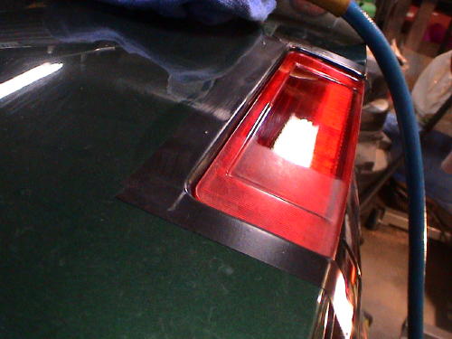

You don't need to go through different compounds to get those results. All you need is plastic polishing compound from eastwood and one buffing wheel and either a drill or a bench grinder to put the wheel on. I used the bench grinder and pulled off my tail lights. It took me maybe 45 min to get them as shiny as I liked.
First thing I did was wet sanded those DOT letters down flush with the rest of the tail light using 400 grit. Then put your wheel on the grinder, turn it on, apply compound to wheel, and polish away....
And here is the third brake light on my 95 when I was in the process...notice which side has been polished?

Damn josh. I'm REALLY jealous now! Now i need to go polish my tail lights.

I polished them last December and that picture was taken about a month after I polished them.They still have 'some' shine to them, but now they don't look like did it that picture.
Of course, the polished look goes away each time you wash your car. If you put a good coat of wax on them after you polish, it will stay better looking longer. I did this on my 95 tail lights and they still look good and I did them in June.
So I haven't really kept up with them to keep them looking that good. But If I did, It would prolly need polishing every 6 months.
