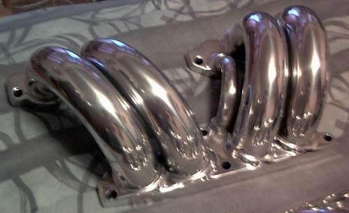

Well its finally finished Thanks 87GTA Runner and SpeedJunkie you were both a huge help in this project and also thanks to anyone else who posted here.:hail:
Now its time to do the runners
I will post some pics in a new thread when I get it installed so be watching out for it.
Sorry for the quality
Look I found a use for those AOL cd's
The sides shine just as well but just did not get a good pic of them.

Man, I just polished up my old runners this weekend to put up on Ebay. It was easy work to get it as far as I did, but man, oh man did I look like I worked in a coal mine when I was done! Covered from brow to hairline and from nose to the collar on my shirt with dark black "soot" looking stuff. I looked like a reverse racoon! Next time, I'm using a full face shield instead of safety goggles only!
Here's a pic. I could have gone much more shiney, but I get bored easily and thought this looked good enough for my "junk" going up on Ebay...

Your polishing vastly improved since I saw those first pics. Good job.
Have fun on the runners, haha these things will make the veins in your forhead pop up when you try to polish the back side.
They are by far the hardest thing to polish, even harder than some rims!!

I want to find out how you polish the flanges. Do you have AIM or something? Lets talk

Most likely a vibration or tumbler type of polisher. I've been thinking of building one of those for a looooooooong time...

I don't believe so. Also, I've played with those with little luck. Felt bobs and small buffing wheels are the best way for the flanges. Tapered rolls to sand them.
I could be wrong, that's my guess. Mikes the daddy at polishing, so I guess he'll correct me if wrong.

Thats pretty much what I do. I've never tried one of the vibrating polishing tumblers. From what i've heard they dont do that great of a job. Anyways I perfer the hands on sanding, wouldnt want the tumbler messing up the tubes afterall.
