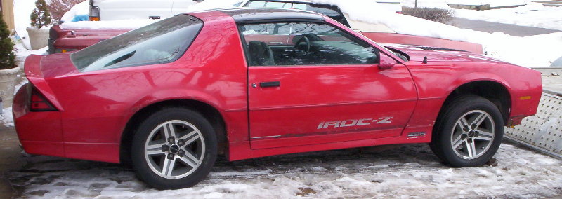

they are the single strip irocs witch im new too, i dunno if they there just stuck on like i said, or they lock, or what have you, i would just like to know how to f-ing get em off
Attached Thumbnails Need help ASAP! on getting these rims off my rear end????????????????????????!!!!! :(-c-documents-settings-owner

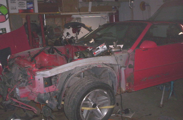

same thing happened today with mine changed the rims off the firebird and went to put them on the TA but couldnt get the old ones off the Ta so i backed into a curb took the lugs off and goosed it in to the curb Pop they came right off....couldnt figure anything else out after beating on them for an hour......
But well worth it Ta looks better with the rims that where on the firebird on em...
Attached Thumbnails Need help ASAP! on getting these rims off my rear end????????????????????????!!!!! :(-mvc-017f.jpg

F*cking, ahhh! both rims, screw lugs, i think these are weld in rims! no engine, but do you think a 400hp +500 foot lbs of TQ Caddy could pulled a gutted camaro around? .... i just dont see these rims coming off!!!!
