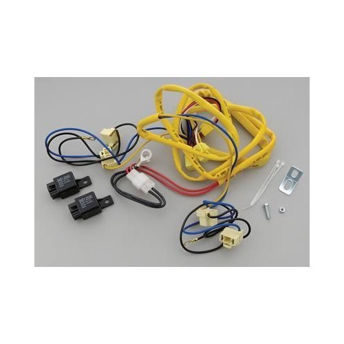

any clue to where i can get this wiring harness or a schematic of makin up my own with 2 relays and some good gauge wire?

Im thinking of something like this for my Xenarcs!
Summit sells a harness by APC, and also one by painless, IIRC. There is a "how to" in the tech section if you want to build your own.
