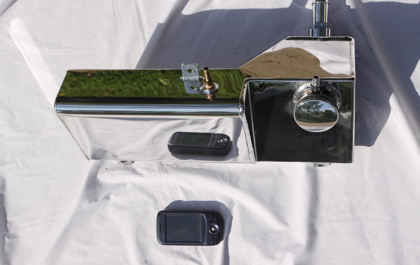

As you can see the reflection of the bottle sucks... At least per my standards... How, if at all possible can i get them to a finish like these? (Pics for reference)
Now thats a real mirror like finish!
