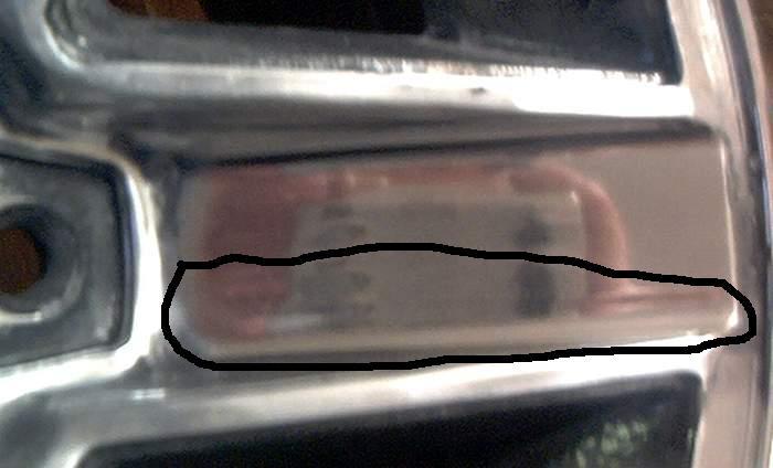

I was wanting to polish my rims, here:
and wanted to have the bare metal parts polished and the painted parts painted black and clear coat the whole thing. I have access to a sandblaster but I need to know what is the best way to cover up the polished parts? I've done this sort of thing on my brothers camaro and know how nice it comes out, so I really want to do it.

I thought a sandblaster will pit alum. Not sure how to cover up parts however. If you want to paint the insides, use some type of tape to cover the part your going to polish. Over spray isn't a big deal since you'll sand all that off.

They make special blasting material that's safe for aluminum. The best way I know how to do it is tape off the parts I don't want to sandblast and use a razor blade to trim the tape, but I want to know if there is a better way to do it.

thats what my polished wheel looks like. you have to strip them first, which is a HUGE pain in the butt if you use spray stripper like i did. if you are going to blast them, as far as i know you have to use an glass beads or walnut shells. i knwo it sounds funny, but seriously...they use shells from a nut (i thought it was walnut..i dont remmeber). sand will ruin them FAST.
then you have to polish the hell out of them. i used blue magic metal polish and i LOVE it.
i didnt paint mine, so i cant offer you any tips on that.

Well, here's the way I'm approaching it. Strip off all the clear coat, which is a pain when you don't have paint stripper, and then use a 1500 grit sand paper to smooth out the maching lines. There was a little part of the rim where the clear coat had come off and tried this, and it came out nice, so I'm proceeding. I'm planning on taping off the polished parts and sanding til the gloss is gone. After that I'll spray on some primer and some black. A question though, should I clear coat the whole thing(including polished parts) or just the black paint?

Sorry. You had said sand blasting not bead blasting I had assumed you were talking sand which would have caused the pitting. As for polishing, you'll need more than 1500 grit. The very least, you'll need to get in the 400s. I'd recommend some 180 to get the machine lines off and move up slowly making sure you miss nothing. Once at 400 or 600 start wetsanding. Following by either a good compound with a buffer or some type of hand polisher if that is the way you want to go.
Z28 Boy, as for polishing goes. That's not really considered polishing. They can almost look like a mirror. If you do it right.
Goto the very bottom of this page. http://www.gmtips.com/3rd-degree/dox...m/pol-plen.htm
And look at the plenum that has been polished. That's a summit catalog. Even below he says it can be made even better. That's what is considered polished. However, usually when you clear coat it, it'll take some of the shine out unless done perfect.

I always liked the look of "miror" polished metals. Looks awesome, although people will have different opinions. Still, my question is unanswered. Should or should I not clear coat the polished parts? Thanx

Easy Z28 Boy. No reason to take offense by it. Lets put it like this, if you take it to a shop to have them "polished" and they do that. You can get your money back. In MOST cases when you polish something you remove cast and machine lines. I'm sorry that you consider that plastic looking. Many people strive for that look. I assumed you were with the rest of us. Once again, easy mistake made by me.
92RSB4C, If you choose to clear coat them. With paint or powerder coating, there is a 90% chance you'll lose some shine. I've heard of people not losing any, but I'll put money on it that you will. Since it's a wheel, you can look at it like this. The wheel be punished by many things. Especially brake dust, grime, and anything that is in rain. From what I've heard you can use a carnuba(sp?) wax once they've been polished and it works like a clear coat. Whenever time comes to clean them use your normal polish. If you don't use a wax or clear coat them, be prepare to clean them once or twice a week very well. Meaning with polish, not a soapy mitt. Otherwise it'll build up and shine like you want. This is just what I've heard remember, I'm using chrome wheels, and I can use a dry towel to clean mine in most cases. It made be that easy. Either way, I wouldn't clear coat them unless you just hate cleaning something once it's done.

Mother's Mag Wheel + Aluminum Polish has a protectant in it that works to bead up water and other things. It works, I tried it. I guess I'll leave the clear off the polished parts and only on the black painted part. Thanx

I looked into having my wheels clear powdercoated, but the place that powdercoated strongly advised me against it. They said clear had a tendency to turn yellow pretty quick. And that sounded really fugly. So I used wax instead. It seems to work pretty good so far, but I haven't had the wheels on the car very long. I used a can of cheapo spray paint to paint the window parts, and I really regret it. The brake dust seems to become embedded in the paint and it won't come clean. For the amount of time I spent polishing the wheels, I sould have masked them and taken them somewhere to be properly painted.

If the powder is good powder, it shouldn't become yellow. But it seems weird that a company would shoot themselves down from money. To pull that dust out, try claybar the painted part.

When he said it'd turn yellow, he was talking about the powder I believe. But it could have something to do with a bare metal instead of using a primer under it.

How do ya like mine
Oh yeah, I did mine in 2 1/2 hours. I use polishing wheels and compounds,da sander, die grinder, and a brideport mill.

The pic that I posted is an old one before I started using the brideport mill to flaten the angles and used a ball nose end mill. After that I used my diegrinder to merge the flat angle to the sides. Then used it to get every tight spot, then went over every square inch with 180 grit sand paper with a da sander followed by 320 grit. Then I used my polishing wheels to finish the rest.Eventually I will get around to painting the rim and putting a good layer of clear coat.
