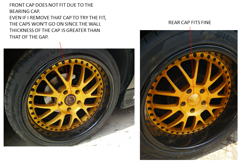

Hi Guys!
Bought some awesome Boze Pro Touring Rims which I am finally mounting. However, the cap on the front rims won't fit due to the bearing cover which sticks out way too much. I've heard people using spacers but even if I do get spacers, the wall thickness of the caps is larger than that of the gap. Any suggestions?
Thanks!
Simon

May have to run a little spacer and hammer down the dustcap a little bit to make it all work. (make sure not to hammer it down to far so the spindle doesn't wear a hole in the cap. May also have to machine the outer rotor bearing surface a bit too.

As TTOP said, it could take as little as beating the dust cap a little. Maybe even that and shims.
Pictures of the whole car? Let's see those boze wheels!
