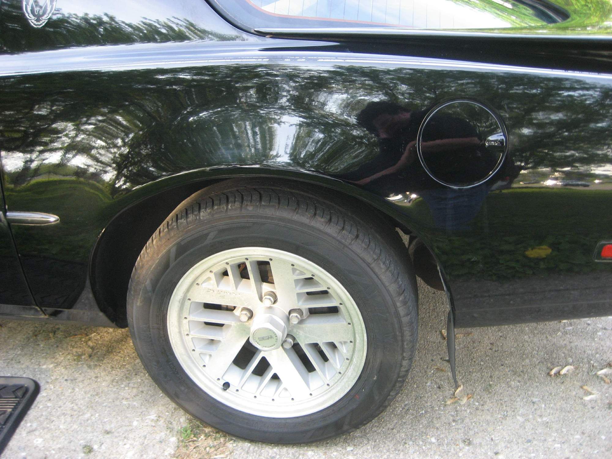

these are the wheels I'm talking about. So I really have to have to take off the tires and rotate them and balance them but not move the wheels? I just hope the tire shop won't screw it up or crack the center caps or lug nut covers.

rims are offset. DO NOT ROTATE TO FRONT. You will destroy inside of rim. It will rub on tie rod.

Yup, all of GMs 16x8 wheels for 3rdgen camaro/firebird have a different front and rear offset.
