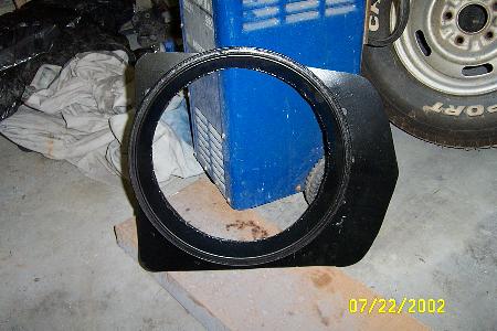

Part II : Making it fit.
Pry the steel mounting plate off the bottom of the fiberglass scoop, your gonna fasten the cut out piece from the hood instead! Put the bottom of your old air cleaner on the engine put the "ring" that you have from the top on top of it, now place the sheetmetal you cut out of the hood on that and theshaker on that. Carefully close the hood and line up your scoop, open the hood and mark where the ring meets the sheet metal and where the sheet metal hits the scoop. Cut the circle out of the sheetmetal and fasten it to the ring (I welded this) now join the sheet metal to the scoop; a couple of rivits and some caulk does it. I cut the back out of the scoop and mounted secondaries off two carbuerators spring loaded to make the scoop functional. Piece of cake!

heres the new bottom part of the scoop
