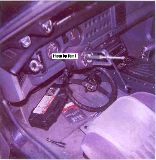

Originally posted by SLOWTBI
please do not buy this shifter...many, many, many people have had problems with this item, including myself. believe me, with all the shoddy design and compromises, it's just not worth the hassal of screaming obsenities at a beautiful car all day and night and day..:nono:
Wow. All day and night? Took me about 2 hours to install mine. I installed it correctly, the first time, and never had any problems with it.
Well, okay, I had one. After using it for 5 years, the shifter cable sheath wore out. I put a new one in, and it's been trouble-free again.
So I doubt 100% your claims of "shoddy design and compromises". And I hope you didn't work day and night on it!
The "issue" with it not fitting a formula is just B&M's careful way of saying "Yes it'll work with your transmission, electronics, and console, but since you have to cut the console lid, and we can't assume anybody can cut a console lid perfectly, we're denying any lawsuit you try to sue us for."
Here's the deal. It won't "fit" in any post-84 Firebird. 82-92 Camaros and 82-84 Firebirds have consoles with "torx-screw" multi-piece console caps. The shifter plate from these can be unbolted separately from the console. The sides of the console are a hard plastic. The console is "one-piece", as the radio console is part of it.
85-92 Firebirds (Formula or not) have a single-piece console cap, and the sides of the console are vinyl-covered. The console is made up of two pieces; the center console is separate from the radio console. The shift plate can not be removed separately from the console cap. So this means the console cap must be cut to allow the new B&M plate to fit.
I cut my console top with a cutting tip on a soldering gun. I measured 8 times and cut once.
The big problem people have with the B&M shifter? They don't follow the directions for adjusting the shift linkage. It's an easy job, but a "pain" to do. You put the shifter in gear, then climb under the car, and check the linkage alignment. Then you climb back into the car, move the shifter to the next gear, and crawl back under the car to check. When you're done with each gear, you re-check each gear again! And to be sure, I tell people to re-check it a third time. So this is a lot of "get into the car" and "get out of the car" work, and people rush the job.
The second biggest problem is that people don't follow the directions for wiring up the electrical portion. They don't buy the relay that B&M says to. They take guesses at how it should be wired, and then wonder why the car only starts in reverse.
So if you follow the directions, and cut your console top carefully, you'll be fine. You can see the "edge" of my B&M Console Megashifter in the picture I've attached.
[edit] Oh, and I installed the shifter back in 1997... so I'm pretty sure it's designed well. No flames intended, but there's no way you can say the shifter's junk!
