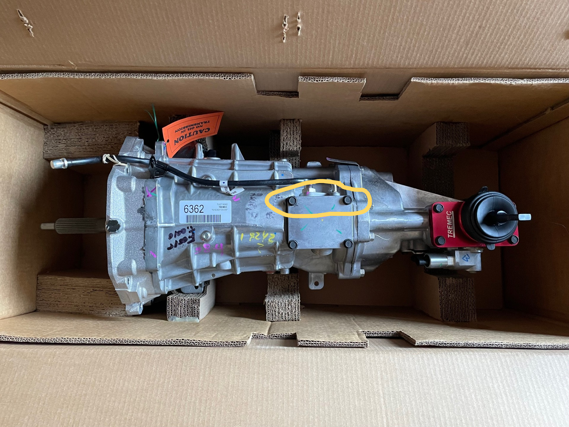

I've got my tunnel cut out about perfectly for my Magnum F's shifter tower. My transmission is actually hitting the tunnel forward of the shifter. Here is a picture of the Magnum, non-F in my LS swapped Foxbody Mustang in my signature:
The part that I circled in yellow is the part that is hitting my transmission tunnel.
The part that I circled in yellow is the part that is hitting my IROC's transmission tunnel.

You have a mix of non-stock parts in mpactng fitment. You have a non-stock trans. and shifter assembly.
And you didn't clearance it.
Shim the mount for your over priced revised Borg-Warner design up. Washer, fender shim, whatever. Driver it. After time, It will self clearance perfectly6.. Remove the shim(s).
If you set everything else up correctly, that's all it takes for an ideally clearanced Install.

I had one of those bolts hitting a fuel line in my 82. Removing the fuel line gave the clearance! But what its the line 3/8th so 1/2 in OD. It was where the fuel lines crossed the trans tunnel. I was running new lines so it didn't matter. In also had to elongate the shifter hole like everyone else. I have a poly engine mounts and a spohn x member so it maybe it a little higher than some(maybe?). Yeah, the magnum f totally fits, but its tight! Ill say this too, try and get it all up as high as possible if you wanna make it over speed bumps!
make sure the bolt head isn't rubbing the body. I had a long bolt rubbing the floor of my old truck. It took months to figure it out what it was. It only made noise on certain sections of highway and it drove me crazy. It wouldn't do it 90% of the time. And then it would resonate through the body.

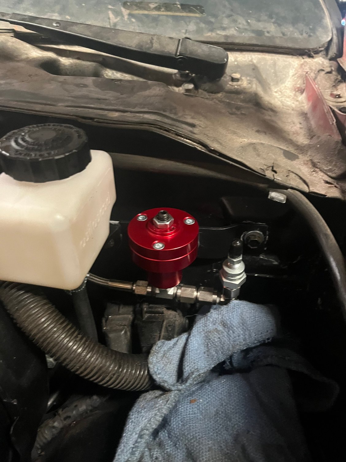

when i put in my magnum f I used a longer 3an line from the release bearing to a speed bleeder mounted up high. I makes re-bleeds super easy. Yeah, the header heat is an issue. I also used heat shielding on the lines (for what thats worth!)
i also mounted the a clutch pedal pressure accumulator in line to help adjust the pedal engagement hight. I have a ram dual disk and the pedal engagement point was high and awkward. This helped me lower it a little.

I currently have a 4' bleeder hose on my Mustang and a 3' bleeder hose on my WS6. Thankfully, neither has leaked. I've got a 4' bleeder hose on the IROC but, obviously, the car hasn't been driven.
I probably should swap the clutch fluid on the Mustang and the WS6.

I never installed the Holley supplied spacer because I could tell that my transmission was getting too high up in the tunnel even without it!
You can see the picture in post #4 where my transmission is contacting the tunnel. I was thinking (dangerous!) that maybe I could lower the transmission, put a piece of thick angle iron over the bolts there and then use my floor jack to raise the transmission back up. The thick angle iron would contact the tunnel sheetmetal and, hopefully, dent it upward. I could then lower the transmission, remove the angle iron and I'd have clearance. Maybe even enough clearance to remove my shims that are currently in place.
Does this sound like it would work or do you think that I'd just damage my transmission?

I found a picture of my actual Magnum F that's in the car so I thought I'd post it.
If you compare this photo to the non-F Magnum in post #4, you can see that this circled area is well forward of the shifter vs the non-F Magnum.

I don't know if I'd bash in the floor just yet. It does look like you need to remove some material around the shifter. I'd start there and see if it allows the trans to find a better "home". For me, that was the biggest interference and I have to wide the stock shifter hole for sure. A hammer blows to the area where it is contacting may be in order but start with the shifter hole first.
On Saturday when I was working on this, I noticed that the red anodized round part of the shifter cover plate (it's under the right side of the round, rubber boot in the picture in post #16) was touching the right edge of my shifter cut out hole. I was able to put a big screwdriver in between and easily bend the metal to provide some clearance. The metal bent very easily.
