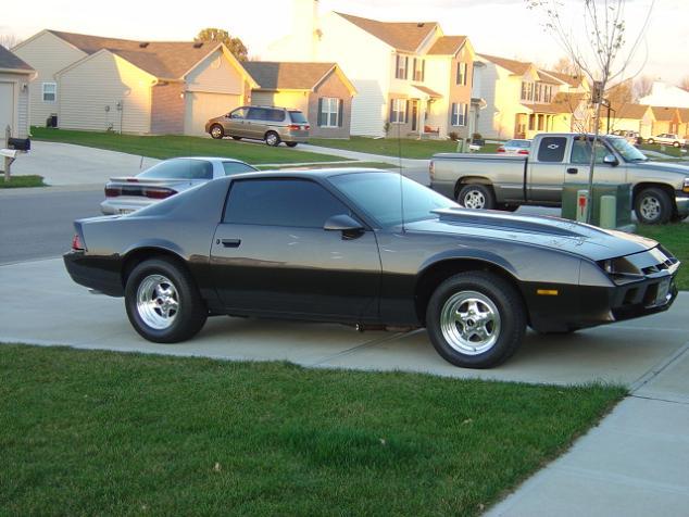

I had my car repainted this summer with ghost flames. The flames were put on after the paint but before the clear coat was sprayed. My friend who did the paint masked the flames off by hand using thin tape, I think some people use some sort of patter to do it. Silver Pearl was added to the regular color for the flames with more pearl towards the tips of the flames and fading into the factory color once you get closer to the front of the car. Then he added a color called Purple Haze to the tips of the flames to make them stand out a little more. It also gives the tips of the flames a slight purple tint in bright sunlight. These pics really don't show how good it looks in person but it will give you some idea of how it looks.

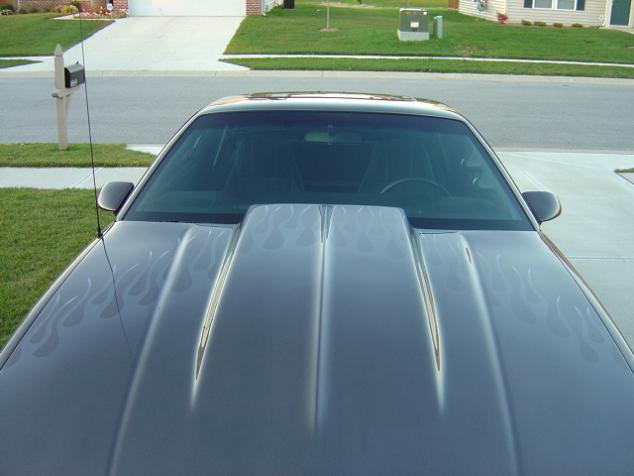

a hood pic

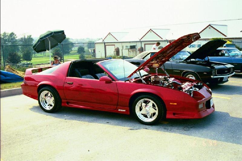

Here are mine. They are white pearl with gold pearl tips. He layered it on pretty good so they stand out more, but at some angles you can't see them at all.
Here's a pic where they are almost invisible-
