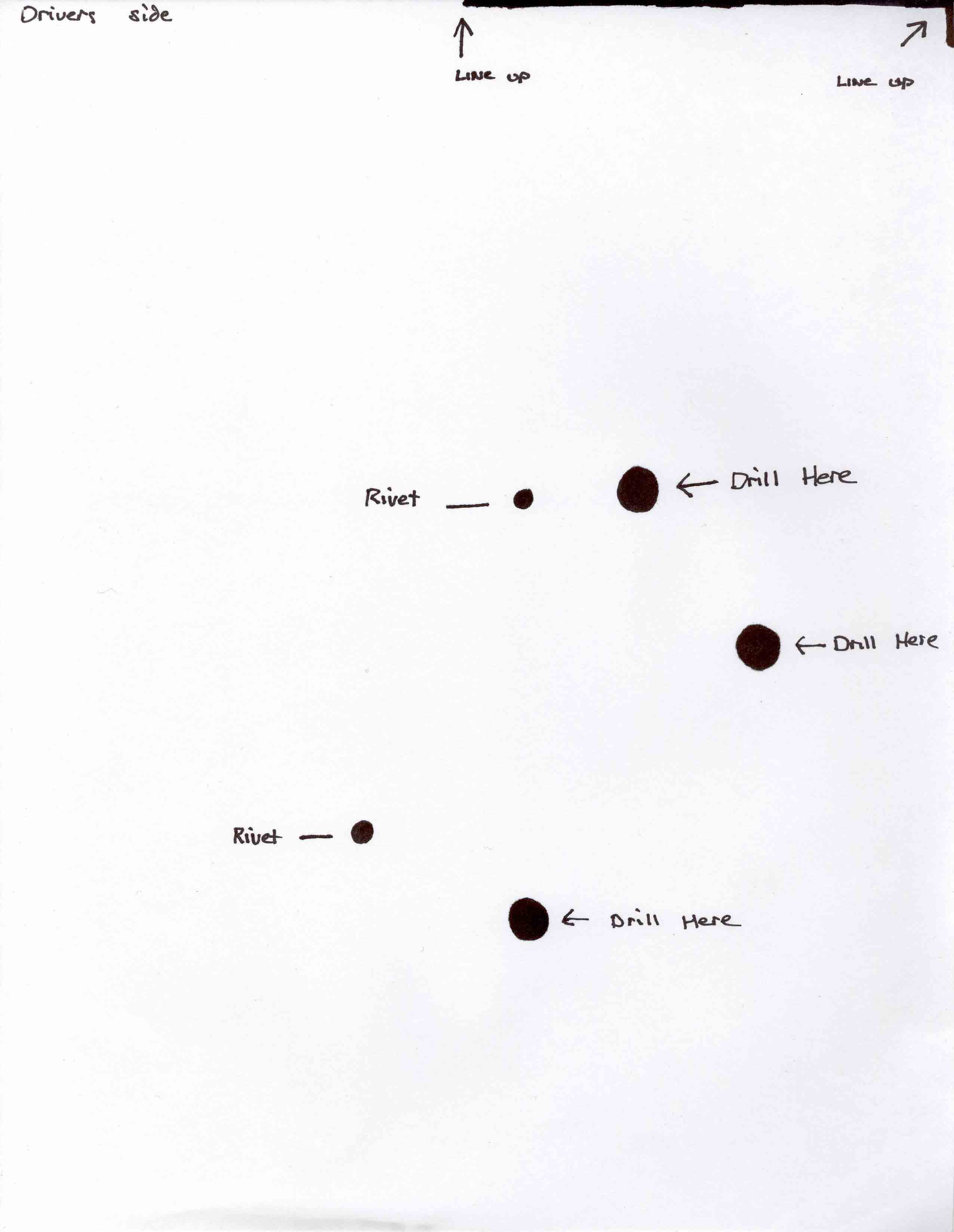

For #2, the motor is going out. Eventually it will move slower and slower and then it won't move at all.
I've only done one window motor so far (have to do 3 more). I used this thread as a reference - https://www.thirdgen.org/techbb2/sho...t=window+motor
and i used this pic as a template - https://www.thirdgen.org/techbb2/att...postid=1777631
Just have to make sure you print it out right. Made it really really easy to do.
