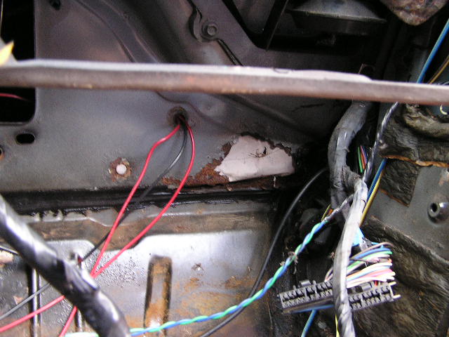

i've had that too, under the a/c box and fan in the engine bay leaves and all kinds of stuff gets stuck in this little area on the firewall and it just rots untill theres a hole (on my car i could stick my fist thru it..) you can get to it from the inside too if you lift the carpet and insulation, its right about where the firewall meets the floorpans

just got a few pix for ya, this is from the inside before it was fixed..
