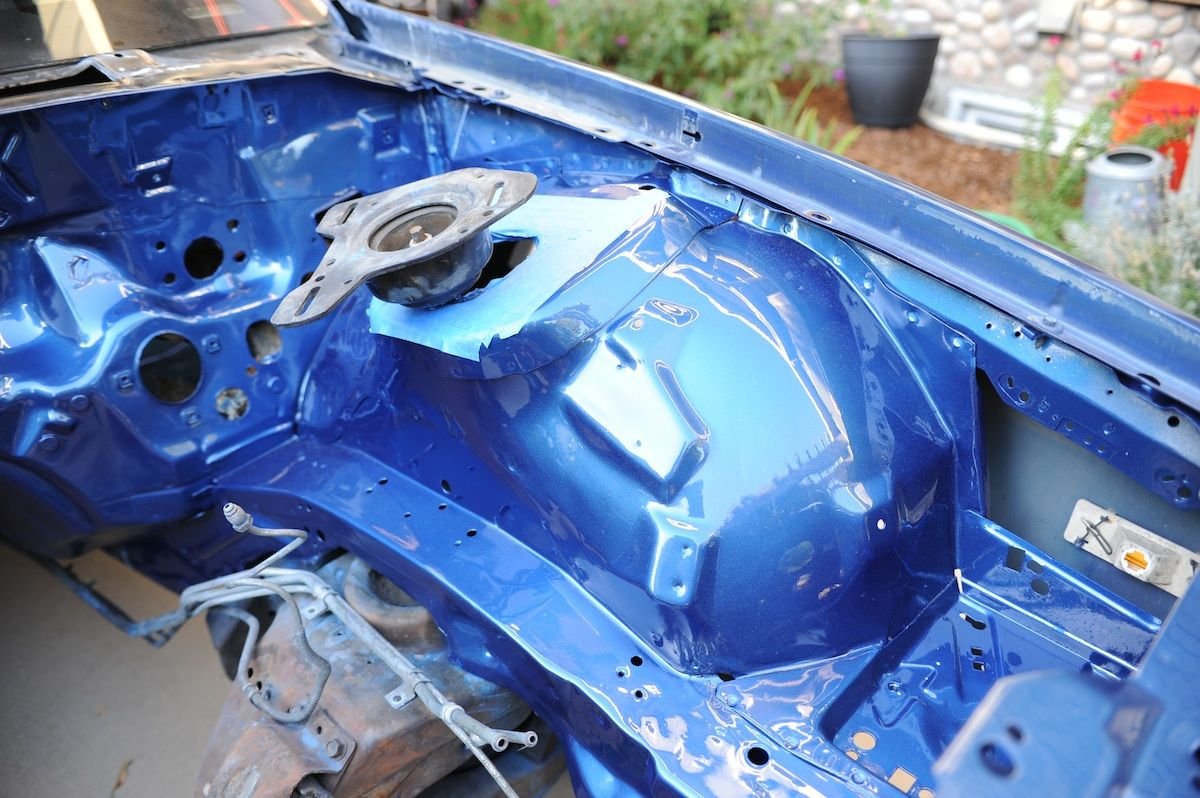

Good! Engine compartment is painted. Next is to pull the cross member and A arms, strip, powder coat and rebuild (Del-A-Lums & Howe 3/4" BJs).
Bad, because it came with a 4th gen rear (4.11s would have gone pretty well with the T56), and I want to run factory IROC wheels. Although the salad shooter 4th gen wheels could classify this as "ugly".
Ugly! PO let water freeze in the block. Cracks below the deck on both sides!

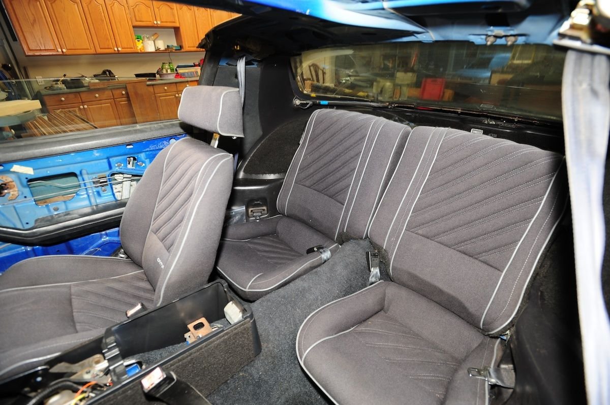

Thanks for the sequeway! The parts car was maroon. Although, it was a toss up to which car to keep and rebuild. The red car had obvious rod knock, and I didn't realize yet the blue car had a cracked block. The blue car had/has slight better paint, red one definitely needs body work... The location of problems (center of hood & passenger side B-pillar/roof) and my preference for blue won out.
- So I swapped interiors; complete decent black cloth from the red car, to replace the filthy, mostly grey in the blue car, which itself had replaced the original tan.
- IROC wheels and 3.42/3G rear end (from the red car) replaced the 4.11/4G rear and 93-era Z28 wheels.
- I sold the red car complete, still with rod, for a bit less than I paid, but got the value out of it.

Dynamat and RAAMmat under the mostly installed black interior.
Old school Nakamichi CD/radio and AudioControl EQ. Between an Aux input in the head unit, as well as front and back of the EQ, I have plenty of options for an ipod. The bezel needed just a little trim at the bottom. And the steel strap screwed to the back of the console, that supports the stock radio was in the way. So, cut and bend some light gauge steel, and clearance was had.

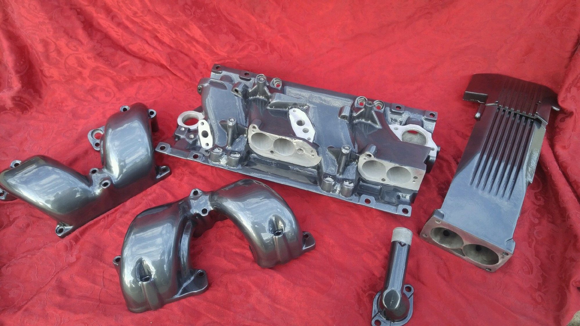

I am calling the intake done enough for powder coating. Here's after-porting, before-coating shots. I am using the Socal guys for inspiration, and I hope to get close to what they've accomplished.
It's always fun to put the parts together, even though they're months away from going in. The engine, and pre-welded/pre-ported runners, and even the T56.

@Brandon & JP - Thanks for the compliments. The intake and runners are with Paul getting blasted and powder coated. I took the K member and A arms to Powder Coating Specialty to handle the bigger parts. I am looking forward to putting parts back on the car!

Here's a picture from the welder/powdercoater. I can't wait to get them in-hand!

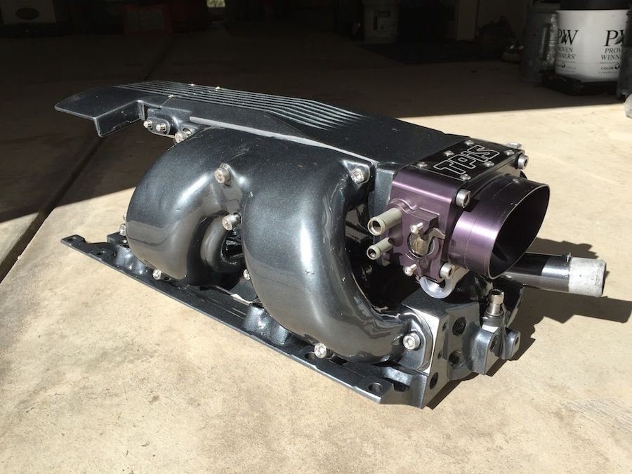

Ta-da! Here is the intake, loosely assembled. The "carbon black" anodized TPI throttle body looks a bit purple.

The powder looks awesome. You should have Paul powder the TB too

Yeah. The TB looks pretty cool on its own, but then kinda looks like crud against the rest of the intake.

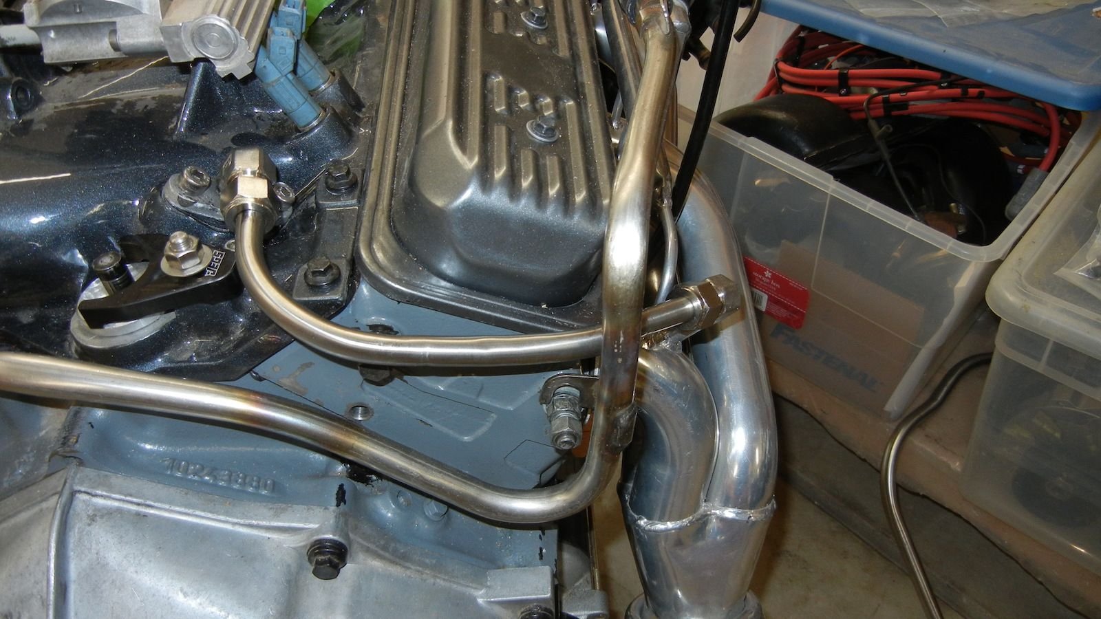

I've been bending tube lately. Here is the external-EGR from a Dyno Don header (Thanks to Vincent for the idea!) to the Edelbrock vortec TPI base. There's 1/2" all around, and I will wrap it in a heat sleeve.
The tube is 3/8" 0.035" stainless. (I also got some .049" because I wasn't sure which size I would use).

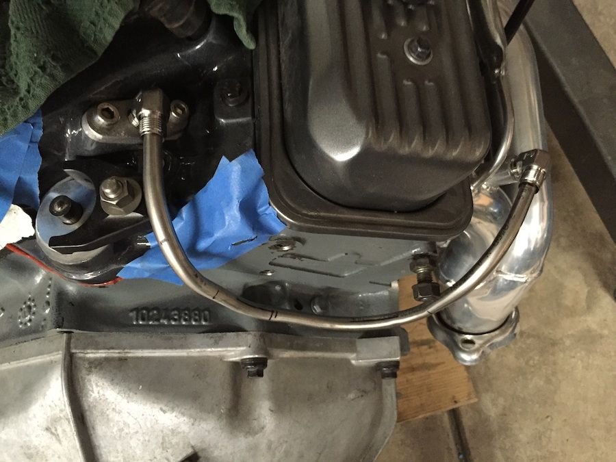

I did run into a potential problem with the EGR: the fitting running into the AC housing. Once I get everything else in place (install header around the dipstick, relocated AIR valve, etc), I may have to lift the engine a bit to head the passenger header into place WITH the fitting attached.

Looks good. Double check that EGR tube doesn't interfere with the A/C box and/or firewall!

Thanks. It's the fitting on the header that hits the AC box.

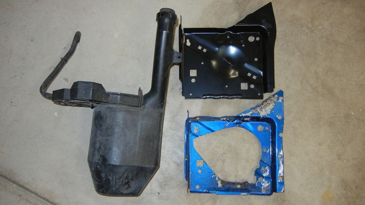

Today's topic: relocating the AIR valve. I found some inspiration from The Project's project...here. Instead of squeezing behind the motor mount, I went in front, directly below the pump. It is snug between the lower radiator hose, but does fit with clearance.
I had welded up the L bracket a few months ago. Sourced some 3/4" mandrel 90*s, chopped them up, welded back together, and coat it with Eastwood's chassis black.

And now for some steps backwards: The 4th gen coolant can sounded like a good idea to tidy up the engine bay. However, it moves the battery up and toward the center of the car about an inch. It's not bad, but not where I wanted to go. So, out comes the painted battery tray, and in goes an aftermarket replacement. You can see how I hunted for some of the spot welds.
About the only positive is the replacement comes with an unstripped battery hold down nut. But, now I need to find the correct threaded bolt for that!
The 4th gen tank is for sale. $55 PP'd and shipped in CONUS. Includes the metal pickup tube.

  3. bent up a new EGR tube... the other one grew legs in the past 5 years, and this one doesn't interfere with the tweaked factory AIR tube. Fully installed, this clears the AC box.

The AIR tube is the factory piece to supply the driver's side. I just couldn't replicate the (tight)bends and brackets. Since I moved the diverter valve, I made/used simple 90* bends - you can see the radius of the shoe - to connect the dots with heater hose. One or both simple-90* bends were cut from my attempt to replicate the factory tube to go under the header to where the valve is... which is too congested with the starter and spark plug wires.
Heater core - Speaking of running things under the header, I still have to figure out how to run hoses to the heater core... without laying over top of everything, and getting between the header and AC box... I have 5/8" and 3/4" rubber hoses shaped like a question mark to run DOWN the firewall. My though was to transition to metal tube to bend 90* and run toward the front. I want to get the car running first, so this is just an idea.
EGR tube -
Having the engine out of the car gave room to move, measure, and test fit MANY times. The compression fitting needs a short, straight bit, so keep some extra length to make the bend, then cut to length. Guesstimating where to start the next bend to end up in the right spot took some practice, and is the real trick.
I ordered the tube from OnlineMetals.com... My first attempt with 3/8" was a lot easier, looked nicer, but I wasn't sure that would flow enough for the EGR to actually work. So... 0.5" OD x 0.028" Wall x 0.444" ID Stainless Round Tube 316 Seamless . I goofed and order 2x 2 foot lengths. Which was just enough for 4-5 attempts to get the bends in the right place.
I used a Baileigh bench mounted bender... I don't think a hand bender would have been enough. 1/2" SS is tough to bend. It was not quite mandrel bender quality, but didn't kink, and covered with a DEI sleeve, it is good enough.
I drilled and tapped a block off plate on the manifold side.
The fittings were stupid expensive (@MSC and Grainger) for what they are... Parker A-LOK 6MSEL8N-316 3/8 X 1/2 Male Elbow, Stainless Steel or cheaper here. The 6 and 8 indicate the MNPT and tube sizes respectively, so you can figure what works for your needs.
The header side - DynoDon added the 1/4 or 3/8 NPT stub when I ordered. I got the idea from one of Vincent's threads.
