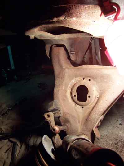

alright im dropping the k member and control arms in myy 88 iroc. well 3 of the control arm bolts came out fine, but the last one is the driver side front. i got the nut off of it i just can't get the bolt to come out. any and all help will be greatly appreciated. by the way i bent a 6 inch c clamp trying to press it out. pictures tomorrow

I had a similiar problem: The bolt is frozen to the sleeve in the a-arm bushing. I resorted to a chisel stated under the bolt head and used a four-pound hammer to beat the head out. When it was out a bit, I pounded it back in using WD-40 liberally I repeated this several times before it came completely free. FYI, I used anti-sieze on the bolts when I put new ones back in.
My experience with the C-clamp was also a disaster.

I had that problem and used a air hammer. If you dont have air i would just cut it out with a saw zaw or somethin.

i was thinking about a air hammer but the garage im in doesnt have air the garage i usually work in does though. how would i cut it with a sawzall? I have a mini sledge i was gonna try today but i dont think theres room to swing it. so i'll probably end up with the chisel idea

Well if i was gonna use the saw zaw i would just cut through the bushing on both sides near the control arm.

hammer and chisel didnt work. Tried saws all broke blade gonna try again tomorrow. But i went ahead and took out the crossmember so i dont have to be on the ground trying to cut it.

this is the one thats getting me
