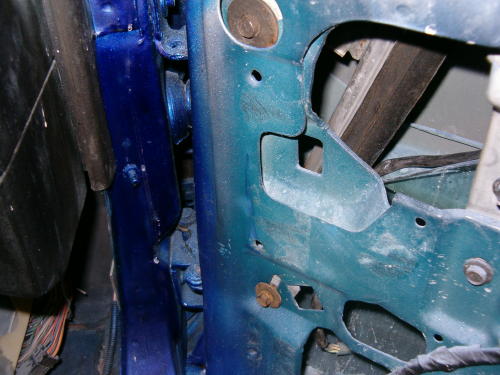

My drivers side window rattles alot and when I have it open part way it moves from back to front by the triangle. Kinda slides alot back and forth. I dont know how else to explain it. How do I fix this? It is driving me nuts.

take off the door panel and see whats going on in there sounds like you have something broken or loose on the window regulator

Thanks I will do that but does anybody have pics of what to look for?

ask and ye shall recieve.
i just happen to have my car in peices still..
first pic two bolts on top right at tringle peice.
second pic 2 bolts in door hold angle of guide.
triangle is part of the window felt track peice.

the two bolt are in line top to botpm on the hinge side of the door. you can see one of them in the first pic also.
hope this helps Jeff
