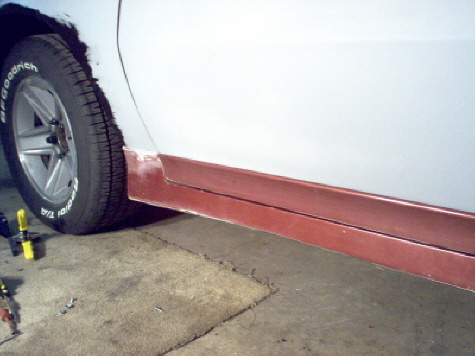

Door gfx
Supermann. Is this what your looking for? This is a look of what attaches the lower gfx to the door. Stud with nut.

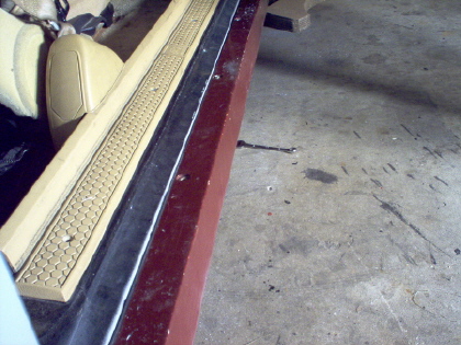

Rocker panel
This is my first involvement with a 3 gen restore. When did Chevy add these braces? My wife had an 83 or 84 with no GFX so no braces. Thanks.

im not sure either. My 88 has those too, did u take your door panel off to take the door skirts off? If so, how did u take your door panel off??

Is there a something that is supposed to run along top of the rocker panel gfx's? It looks like something is supposed to cover it when it is attached to the body, like an extension of the door still?

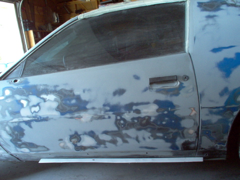

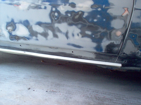

I've recently added gfx to a non gfx car, I can show you what I did. I believe the original rocker brackets were welded on. What I did was I riveted a strip of aluminum to the rocker panel. I know this isn't quite as strong as the brackets the cars originally had, but i mounted the gfx before paint to make sure they were solid and lined up well. I also drilled holes in the fenders and rear quarters for the other studs on the gfx. it's kind of guess work to locate where the mounting holes should be, but even from the factory the brackets weren't mounted with great accuracy. I just held up the gfx and drilled some holes. Also, I alternated the placement of the holes that go into the top of the gfx and where the rivets hold the aluminum to the rockers. Anyways, here are some pics of the process.
Attached Thumbnails Putting GFXs on-c-documents-settings-lisa

Axle/Gears: 3.08 drum
another... can anyone tell me how to post multiple pics in a post?

the holes in the top of the rocker gfx are to mount it to the part of the bracket that extends out under it. I believe the gfx are held down with 7mm's w/ washers, but I'm not sure off hand.

no man your not missing anything, those screw wholes attach to the inner door wall. Hook the rocker panel up as normal, and you should see were they attach.
