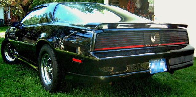

Oh, uh.. here's my 12/13 year old paint job. PPG DP epoxy primer, PPG K36 2k primer, PPg deltron BC, PPG DCU 2020 clear, All top o' the line sh#t, 13 years ago.

Kevin, I gotta tell ya, that is one slick paint job. That looks good... really good.
