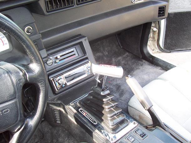

I didn't bother with installing their shift cable, so I had to cut the rubber stop on the stock the cable to fit with the shifter and not move around when I shifted. Also, you have to fab new mounts for the shifter, and the stock console shift plate has to be pretty much replaced. I traced my original one onto a peice of clear plexiglass, cut it, sanded it, and sprayed it with black truck bed liner, which matched perfectly.
I didn't buy the console Megashifter, so I'm not sure how well those fit into the Firebirds and Camaros. For me, it was a PITA to install, and I did it without seats or a console in the car. I love the shifter though, it looks great and adds alot to the look of the car.
Attached Thumbnails megashifter install-c-documents-settings-owner
