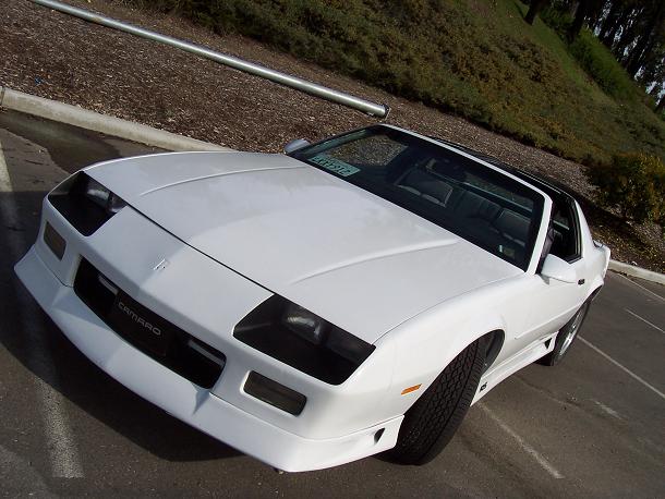

Yes but wouldnt that make the fascia not match up with the fenders if it is yanked up where the hood is???Any pics of yours??
I tried the latch that didnt help...Im beginningt to lose hope becuase two years ago she was in an accident and i think the body shop didnt quite fix everything perfectly...if this fascia idea will work..i would like to see some pics.meanwhile ill give you a shot of mine...

pic...she hasnt beem washed in about three weeks so excuse the unattractive mess..

My car looked exactly the same. All the washers will raise is the area between the headlights. I don't have any good pictures now because my hood is off for an LT1 swap, but here are some pictures of what my car looked like after I used the washers to raise that section. The only place you want to put the stacks of washers is where that plastic cover is between the headlights, and that's the only place that it'll lift.
pic:

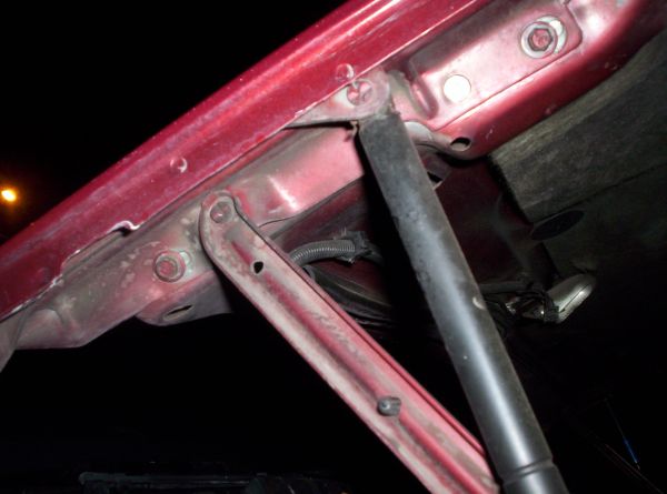

Dude! Loosen up the 10mm screws that hold your hood to the hinges. Slide the hood back an inch or so and your problem will be fixed. Don't mess with the latch just yet and don't use washers to RIG (yes I said rig) the front bumper cover.

I'm assuming your talking about these..how do I adjust them without the hood falling on my head??

It looks like the body shop already did that soooo. You need to adjust where the hinges bolt to the fenders. You will see the 10mm bolts on the bottom of the hinge assemblys. Loosen and move back an inch and tighten them back up. Close the hood slowly checking for clearance on the sides. If all looks well let it close. Post pics of your newly aligned hood position.
