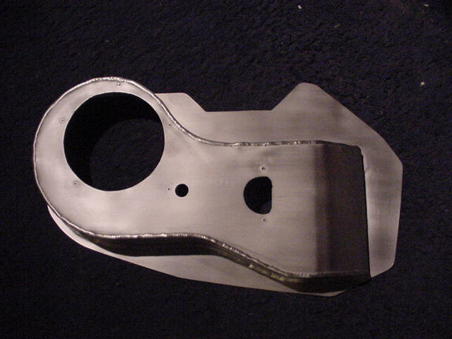

Aluminum heater box
Hey! Has every one heard of the TIG welded Aluminum non AC Heater Box that "88IROC " has made. There are pics of it he posted on the site here ( https://www.thirdgen.org/techbb2/att...postid=2323665 ). I think he has only the one now, but said he may make more. Wow would they look great if they were polished.
