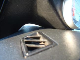

Has anybody else had a problem wih the Auto Meter12201 triple A pillar pod cover fitting correctly? The bottom pod is hitting the dash--BAD!. When U look down the pods in line with each other, the bottom pod is rotated clockwise, and the amount that it is off is what is causing the problem. It is off so much that it cannot even be "persuaded" to fit.

I cut the ends off mine and moved it up as far as possible, I've got some pics of what I did but I can't post them up here, they're too big. I don't have them hosted either. If you want them I can email them to you.

The bottom address is for a pic posted on the thirdgen board--not my car--I would not have a problem with it just resting on the dash, but when it is pushed down to where it matches the top and bottom of A pillar, the outside of the pillar cover is almost an inch away from the A pillar because it is being distorted and twisted.

Already cut, but not installed--A BIG THANKS! Actually looks pretty good!

HG the moderator sent me some . I'm not sure i still have them--basically U cut some off the bottom and the top, so it's just the shape of the main pillar--U are cutting the "curved areas" off both ends and slide it up so bottom pod clears the dash and attach as normal--they provide little plastic christmas trees to stick through holes U will drill through the OEM a pillar.

I had fitment problems too. thought it was cause I sound proofed under the dash which might have made it sit taller. Mine hits the dash pad. I made it fit w/o cutting though, just pushes into the dash pad a touch
