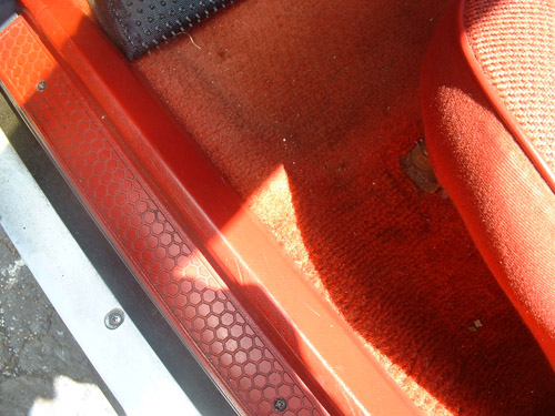

Hey what did you guys use around the edges by your door? Is the carpet suppose to snug into something to hold it there?

Yeah, it tucks nicely under that piece that you see when you first open your door. I've never known the name of it...it runs the length of the door, i've always called it the Threshold. If you need any pics, let me know.

Here - hopefully this is what you're talking about. The plastic trim piece that runs the length of the door hides the ends of the carpet.

OOOOOOOOOOOO yeah i forgot about that piece!!! Now then, where did i put it? lol
