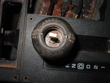

While we are on the topic of the shift *****, how do I get mine off? I have an 86 IROC and need to take the console out but can't figure out how to take this **** off....

you have an auto or 5 speed? the 5 speed **** just screws off. the auto, i think there's some kind of clip on the bottom that you have to pull out.

In my 92 and in a 4th gen firebird (yours should probably be the the same) the auto shift **** just has a clip in the back off the **** down towards the bottom, you can feel it with your hand.
Just jam a screw driver in under it and pop the clip out then the shifter should slide right off.

Thanks for the replies gents, here is what I found.
On the 86 you have to pull the button out of the top (just a tension fit) and there is a snap ring inside the ball to remove.
