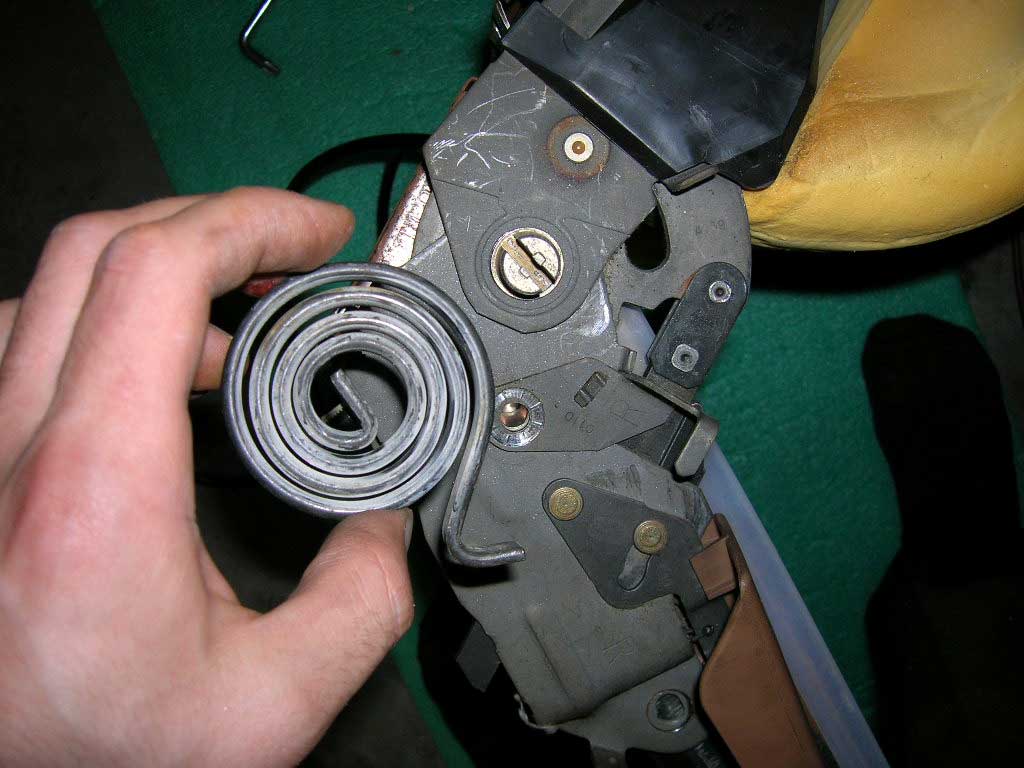

Old Sep 14, 2005 | 10:28 AM
formula1vhs's Avatar
Posts: 26
From: GORIZIA , NORTHERN ITALY
Car: 1989 TRANS AM GTA
Engine: 350 CU 5,7L
Transmission: TH400R
ok , here's the pic of what i mean:
this one is the damned hellish SPRING
Attached Thumbnails Seat back return spring! Please help ...GTA SEATS-spring.jpg

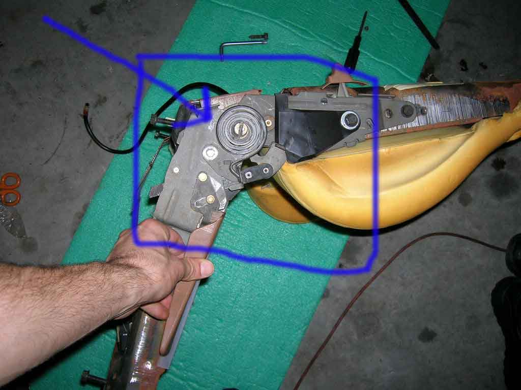

Old Sep 15, 2005 | 09:25 PM
TorchRay's Avatar
Joined: Jul 2002
Posts: 704
From: Granby, Ma US
Car: 89 WS6 Formula
Engine: 305 TPI w/ some mods done
Transmission: Modified THM700R4
formulavh1:: I think i understand what your talking about. Are you saying that the lever that you pull to make the back of the seat go down and then spring back up is lose and doesnt do anything? if so..i had the same problem. Ill try and explain it the best i can. Ill see if i can get a pic for you tomorrow but i tried to use yours the best i can. There is a spring that goes in like the middle of the assembly that hooks around the metal frame work..and then hooks around the seat lever, that allows the lever to spring back and fourth and also allows the seat to spring back and fourth. Heres the pic. Hope this helps out somewhat. let me know if it does.
Attached Thumbnails Seat back return spring! Please help ...GTA SEATS-assembly.jpg
Old Sep 17, 2005 | 12:58 AM
84 1LE's Avatar
Joined: Nov 2002
Posts: 6,652
Likes: 407
From: Oyth
Car: 89RS vert
Engine: Erod
Transmission: 4L65e
Axle/Gears: BW, 3.27
That spring is more for the handle/lever.It is between the frames of the recline assembly.The coiled spring he is refering to makes the reclined seat go back up.It has broken loose & getting it back on can be hell if not a bit dangerous if it recoils & breaks loose while trying to re-install it.It looks like you will have to turn it clockwise to pre-load it.It looks to be in the wrong spot in your pic.Be careful.

Old Sep 17, 2005 | 07:46 PM
TorchRay's Avatar
Joined: Jul 2002
Posts: 704
From: Granby, Ma US
Car: 89 WS6 Formula
thanks 841le for corecting me and putting the recoil spring diagram in the picture. Hope this helps him out.
Old Sep 30, 2005 | 03:29 PM
Posts: 26
Engine: 350 CU 5,7L
this helped me alot!
Thank you.
It was a pita.
I wrapped a big metal wire (eletric)to the spring, i've bolted the assembly to the table and with a buddy we have pulled as damned and with the help of a screwdriver whe doed it!
